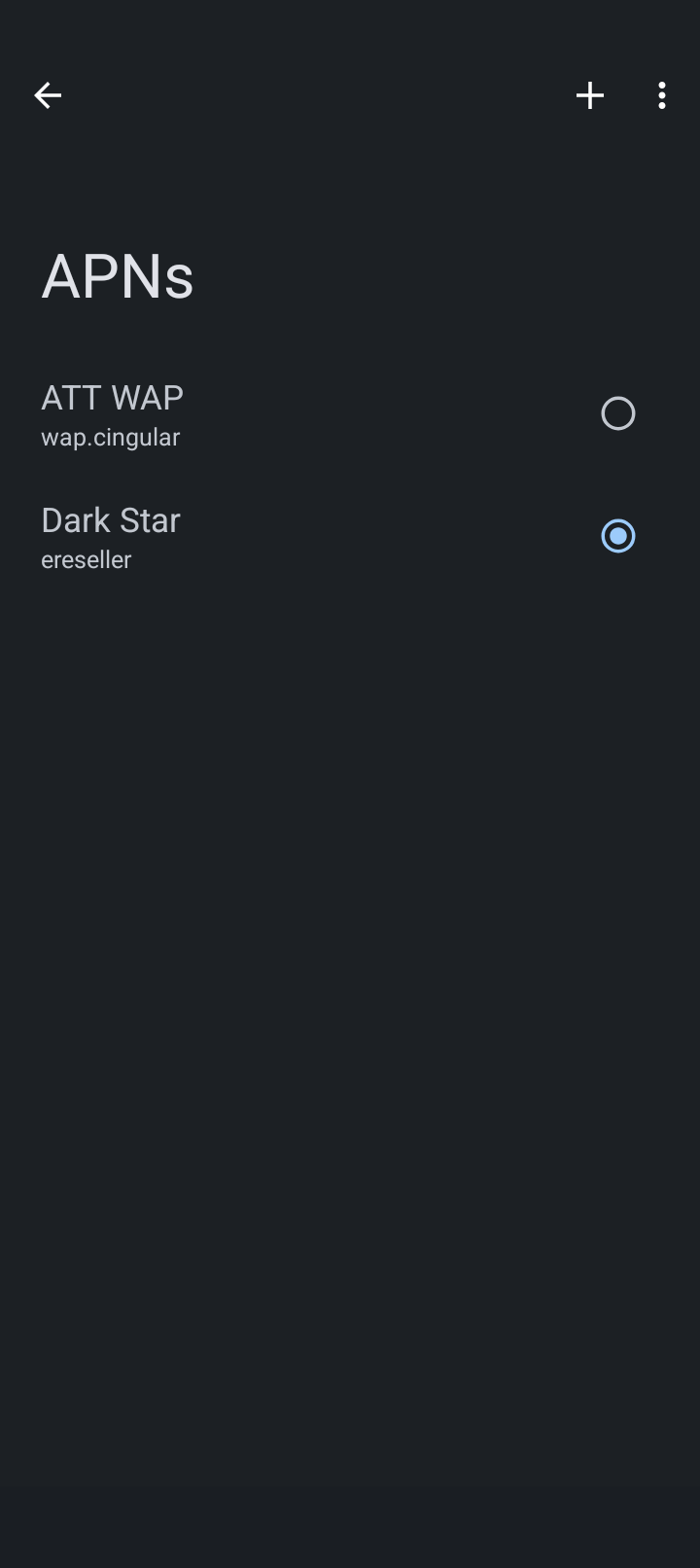

@plamen can you please mark US Mobile AT&T’s network (they call it “Dark Star”) as working? I hadn’t realized that any AT&T MVNOs were working, but this post is indicating it has been working for some time, and has the APN settings that may be needed:
This means that only the US Mobile Verizon (“Warp”) network is not compatible.
