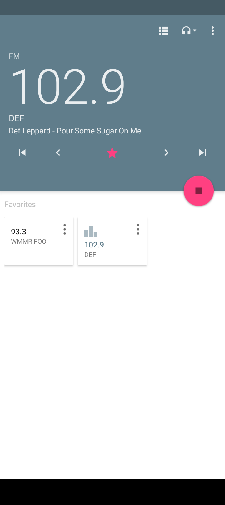

We have lots of HD radio stations here! The FM Radio app displays the song and artist being played just like the HD Radio receivers do. I think that’s the only way to know if a radio station is broadcasting in HD.
This is probably regular RDS
Yeah, that’s from RDS, a different set of digital data that gets sent along. HD Radio is something different, and includes a digital version of the main audio, as well as (for some stations) additional audio stations.

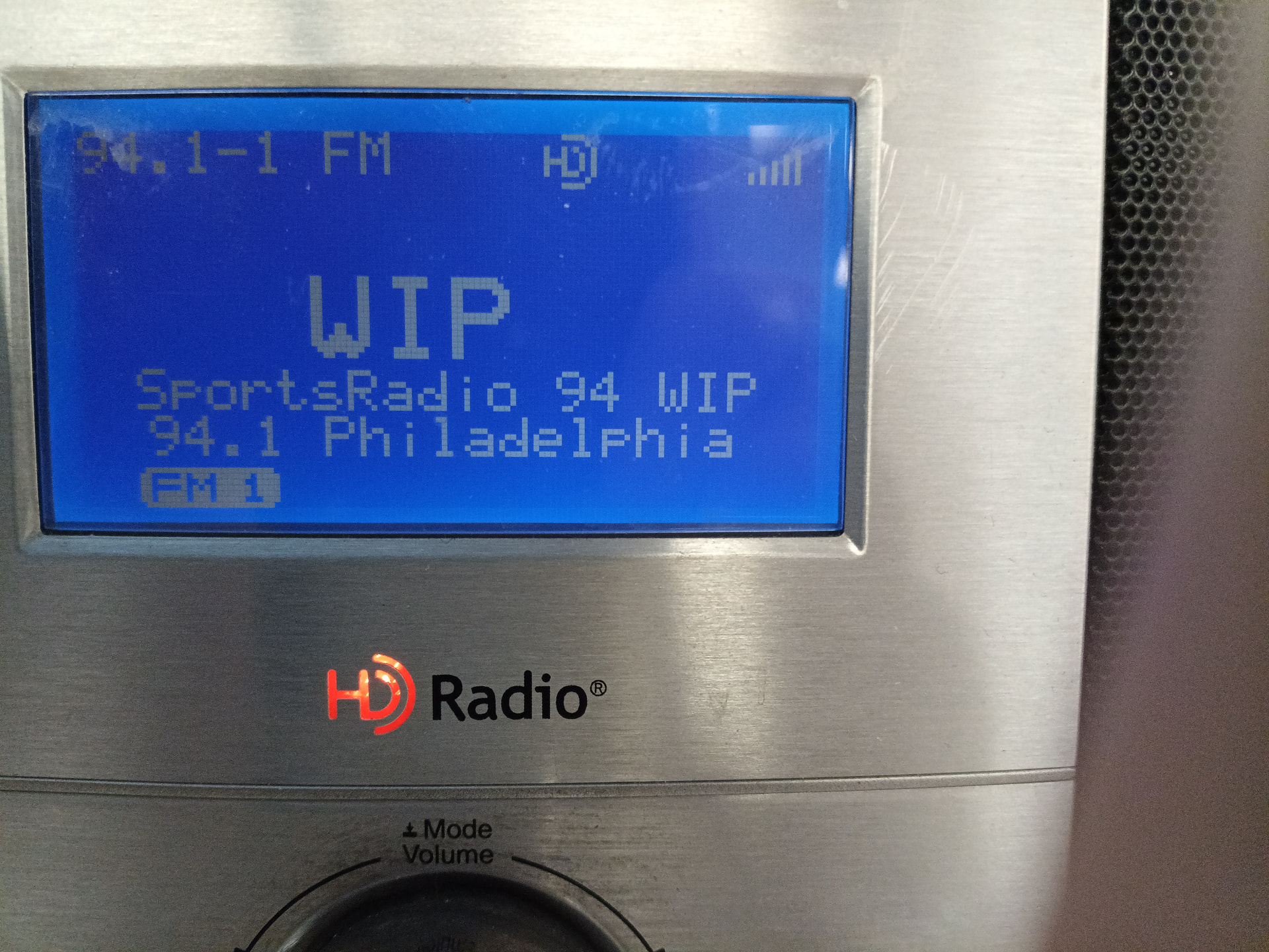

There is an HD indicator on digital radios when the station is HD.
