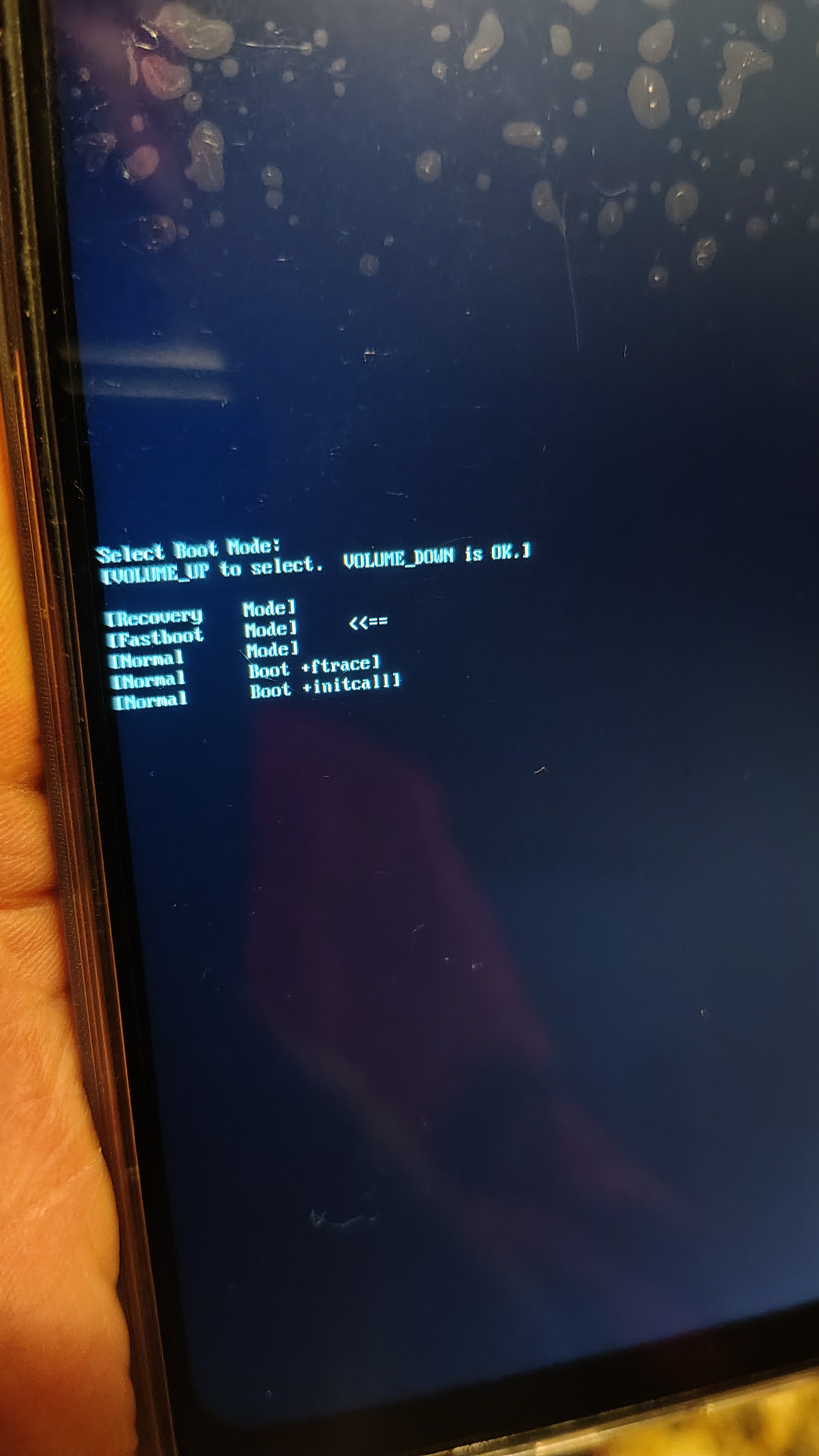

Hola Team! For the past 45+ minutes my Brax3 phone froze. I am not able to shut it down, too. I’ve pressed two and three buttons at the same time, nothing worked. I then pressed down the shutdown button for a bit longer and it came up with a different boot screen. Photo attached. The volume buttons are not working to allow me to choose normal. I cannot lose the files I have in there. What can I do, please? At this present time, I still have the same screen not allowing me to do anything. Gracias!

Gracias, for replying! I pressed the shutdown button for a bit, and it finally shut off. I stepped out of town got back after some hours, turned it back on, and it went right back to the same boot screen. The volume button is still not allowing me to scroll up and down to choose a boot mode as shown on the photo attached earlier. This is insane!
Most likely disk corruption any other signs when turning on, contact brax support they might be experiencing more issues than normal lately because I have been waiting for a reply.
There are some faulty devices from time to time, you may need to replace it, they will send you a code to ship it back, in the meantime you may can access it through a USB cable, the Mediatek tools may can create an image of the internal memory or help you to revive it for a short time until it breaks again.

Gracias everyone! Yesterday, I did reach out via email to tech support, after reaching the community support website. I received an automatic email reply that they received my email and will reply if pertaining to ordering and delivering, but suggested that I go on this community site. * I did reply informing them that I’ve already reached out through the community website and I still need help. I just recently started using the phone, made a couple of phone calls and text, and just ordered a SIM card for the second phone. I don’t expect to have issues with all Brax products I buy, as nothing is perfect, but I do expect help from the company. MEANWHILE, AS I WAIT FOR THE COMPANY REPLY VIA EMAIL, if anyone else has any more tech suggestions, so that I don’t lose my important files, please advise me. Though it seems I can’t move any further. BY THE WAY, I did let the battery run out completely, hoping that would make a difference, but it still returned to the same boot screen not allowing me to do anything else. GRACIAS, AGAIN!

Remember, none of my buttons are scrolling either.
