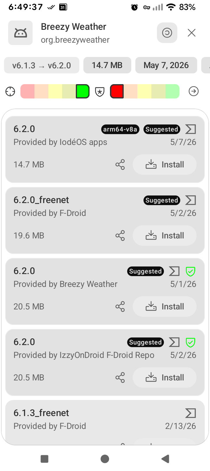

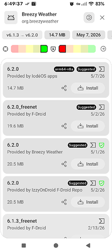

Question on breezy weather. Shows update 6.2.0 but it’s pre-installed… Q1: can it be set to fdroid iodé updates in the future if possible? Q2: why wasn’t v6.2.0 updated in last 7.5 OS update?
Thanks
Mine is 6.1.3 and that is the latest release in f-droid. Do u have a link for the 6.2 release?
Breezy Weather IodéOS 6.2.0 release has been available since 5/7/26, but because it’s preinstalled in Brax3 IodéOS it will not install as a standalone, and has to be updated through IodéOS monthly updates. If you already know this sorry…

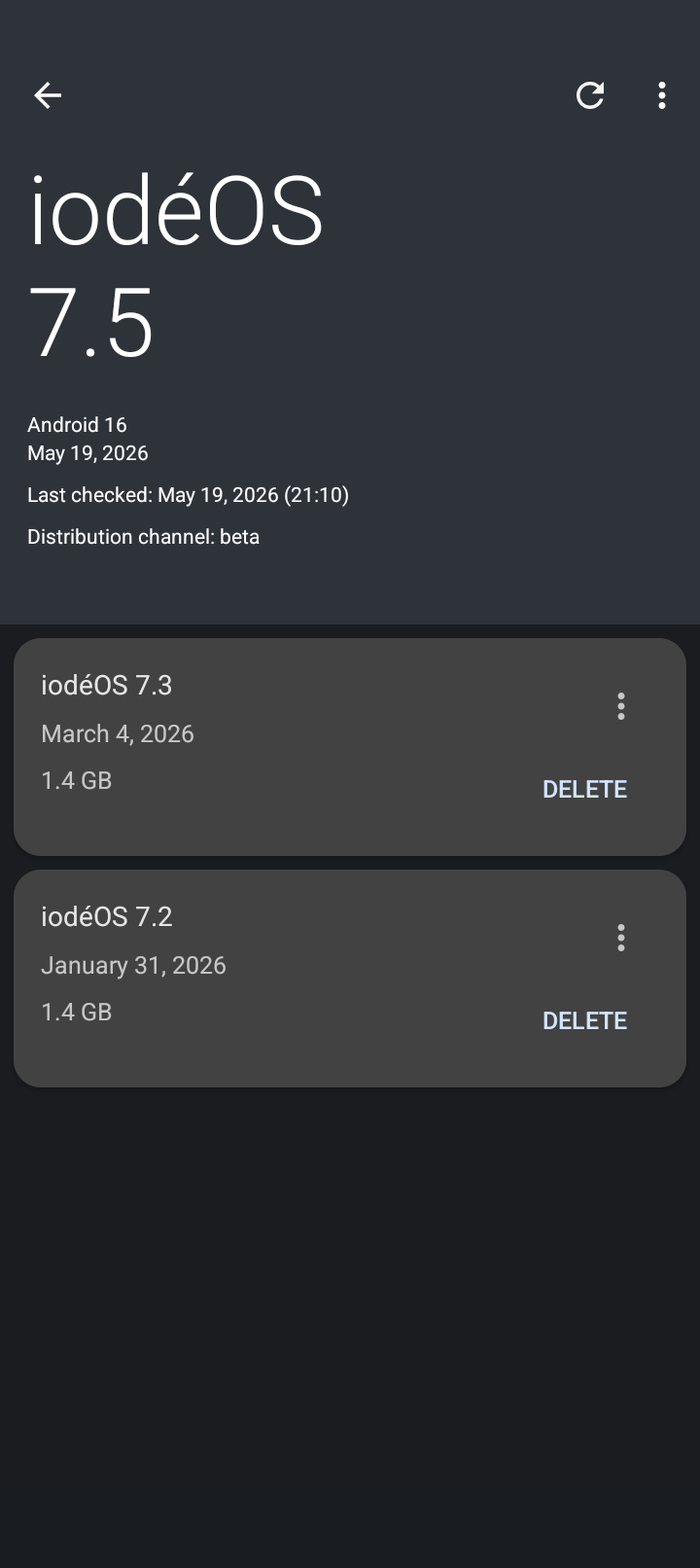

So is it best to use your link instead of the one in updater? I started the one on updater - after 15 min or so 20% was done w 2 Hours left? My wifi is way faster than that. So i paused it​:woozy_face: Thank you!

How long did it take to download? This is what i get---- my network is much faster. So i am back to pause..…
Arrrrgghh cannot figure out how to post a frickin ss! Well it says 30% done 4 HOURS TO GO??
If i use this one do i just pick all of them???
Wow-longtime! It took me a couple minutes on home WiFi. Are u downloading from mobile data? Turn off 5G on your phone and force it to use WiFi!

That was on wifi and my wifi is faster than that,lol. I was doing it through the updater tho, maybe that is it. I hit pause and left it. So my next challenge will be to find this post on my phone as I am on my laptop now. Then download the OTA files.
