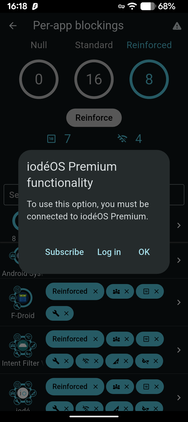

Iodé Premium no longer active on my Brax3
I have posted about this in chats at Brax user tips etc., but have found no solution/response. Currently on 7.6 and plan to either go back (if reasonably simple) a version or 2, or at least no further updating. Please advise, how to “re-activate” or otherwise “log-in/register” to enable iodé Premium. The most direct answer I have found was from Dec 2025 “The issue is identified and a hot fix is on its way.” That’s as far as it goes, and the thread has long since been closed.
This is fixed in 7.7
No, that does not appear to be the case, as I have just rebooted after 7.7 installation:

When I click on the iodeOS Premium Login, its asking me for a login and password.

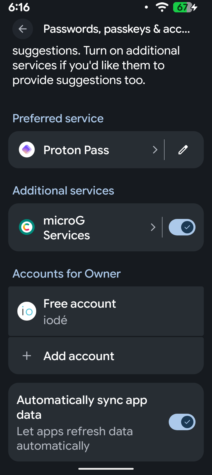

Do you see anything under the settings/accounts page as mine shows an account and says “free account”.
