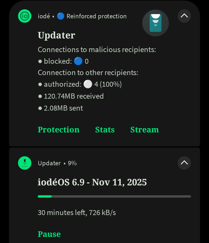

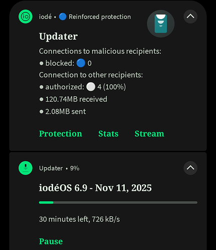

Is it me or does everybody elses update take hours to download or is it just AT&T? I don’t know. Doesn’t matter if I use my AT&T router or use cellular, although sometimes the cellular is only half hour or so.
Mine’s about 5 minutes on 5G WIFI off my home connection. Cell data, I can’t say for sure. 1.5 gigabytes is a big download!
I downloaded it in under a minute. So, I think it is your AT&T.

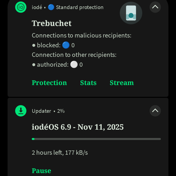

Very unlikely that it’s your AT&T. The update server for iode is in Europe so it takes longer to update if you’re in the states. We’re discussing improvement of the infra so that updates are delivered faster globally.
Is a pain over my WiFi.
The cellular is faster.
Made a lier out of me. Still downloading. Says an hour left. :frowning::enraged_face::face_savoring_food:
If you have a slow download did you have a VPN on…?
I had to turn mine (Proton) off temporarily - went from 11 hours to 4 minutes (and thats in NZ).
No, haven’t got a VPN yet.
