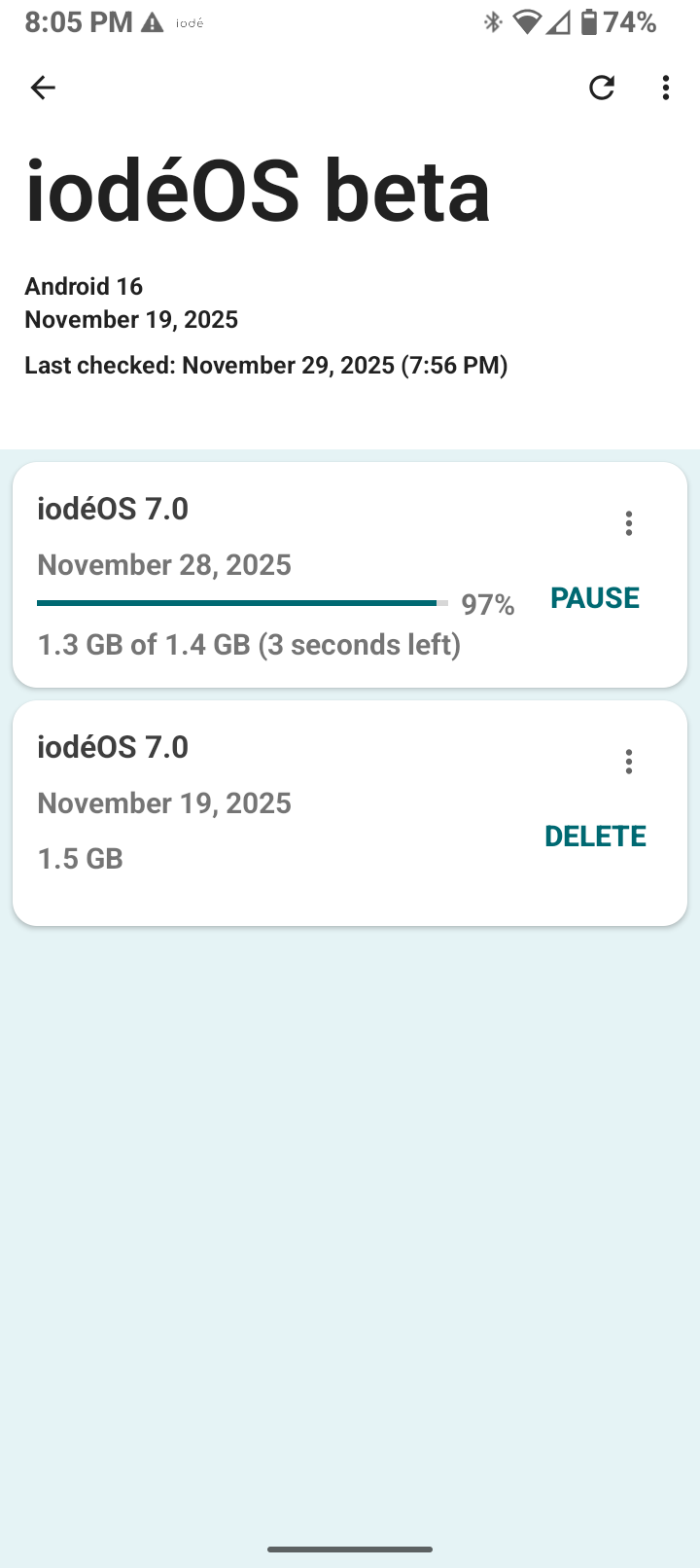

iodeOS 7.0 update blocked
Which we are apparently not allowed to install.
I’ve been running the Betas, and yes the 1116 version did finally fix the login issue for me.
Thank you everyone for that.

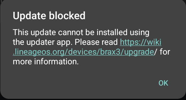

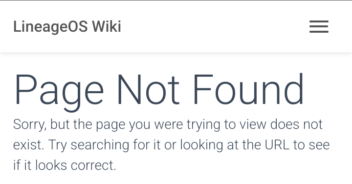

This morning I’m told by the updater that 7.0 is available and that I’m not allowed to install it. I’m told to look at some random wiki address, a security risk too me, for a page that does not exist for instructions on how to install this apparently useless update (because it can’t be used).
What is the deal here that the updater can’t update?
The non-existent instructions might have answered that…
How about a screen shot of that update?

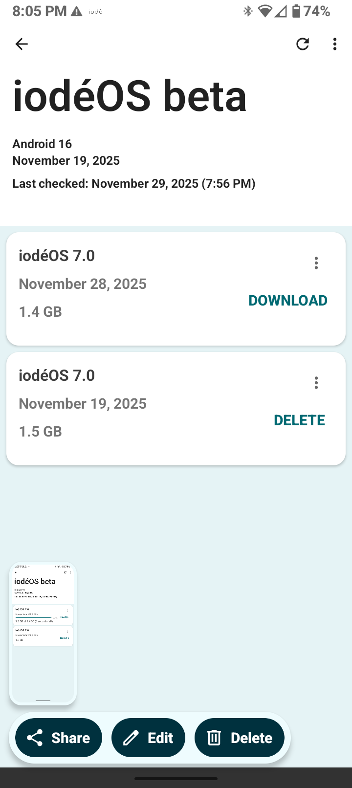

iodeOS 7.0 update has only INFO button
Clicked on it. Got same error.
Clicked on a link.
Hmmm. Believe I would sit this one out.

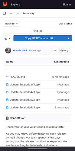

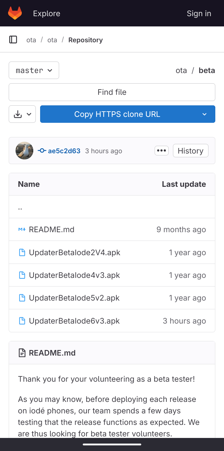

The beta updater must be updated to this version : beta/UpdaterBetaIode6v3.apk · master · ota / ota · GitLab
Thank you. Downloaded and installing 7.0 now.
Could someone please fix the broken link for others?
That’s not useful, because users on the official release channel will never see that popup, and never have to follow that link. It is a problem related to the previous beta updater. Lineage has blocked upgrades to major updates unless a system propriety is set to true, which we saw recently (so after releasing that beta updater). A clean solution will be set up for users in the official channel.

The issue is we are told to read instructions that do not exist, not which updater is at hand.
If the information was there correctly on the Wiki via working link, then this tread would not even exist. We all would have just followed the instructions, had they existed and called it a day.

I sideloaded the ota wirh no problem so far

Tried install iodeOS beta 7.0 - 28. nov 2025 twice, got error “Verification failed”.
Same here.
Looks like we need a revised Updater apk to launch 7.0 20251128.
Starts download, gets to 100% the message at bottom, “The update verification failed.”
Returns to “DOWNLOAD”
Which version of the updater are you using?
@plamen
No need for a new version of the beta updater yet. The issue has been fixed, you can refresh the updater and install the new beta.
Successfully updated to iodeOS 7.0-20251130-brax3 beta.
