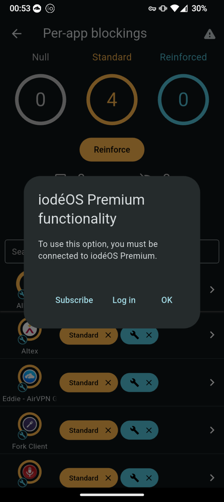

iodeOS Premium functionality - not working on Brax3

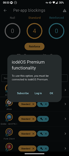

I tried to activate Reinforce option and I get the message : “To use this option, you must be connected to iodeOS Premium” …I thought that Brax3 phone has lifetime premium functionality…

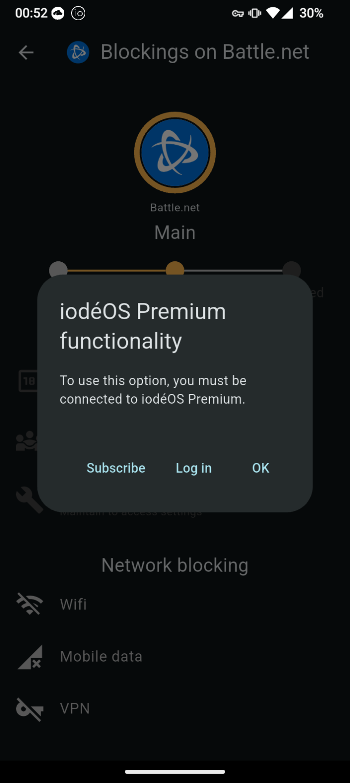

Also if I select and app from the list and select “Customized blockings(advanced) it cancels that option and I can’t reactivate it on that app, it says the same message : “To use this option, you must be connected to iodeOS Premium”

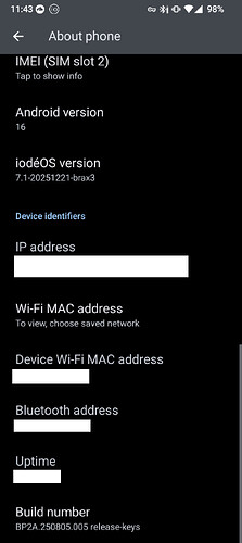

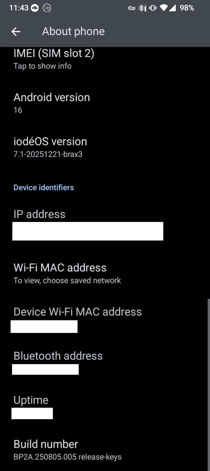

What do you see in
Settings > About phone > Device identifiers ?
Don’t screen capture it here.
It is supposed to be using some hardware identifier , I’ll have a look in the code.

I just started using the phone even though I have it for months…I set it up with the latest update and after I tested apps I did a factory reset and set it up again. After I finished I noticed the problem with the premium functionality… What is the default Device name in the About phone menu? Is it “BraX3” ?
Yes, this is not important, you can change it.
I tried changing it to default “BraX3” name because I suspect there is a bug somewhere that messed up the registration, but this doesn’t fix it…in the Device Identifiers do you have another attribute that doesn’t show in the screen capture I posted?
The issue is identified and a hot fix is on its way.
