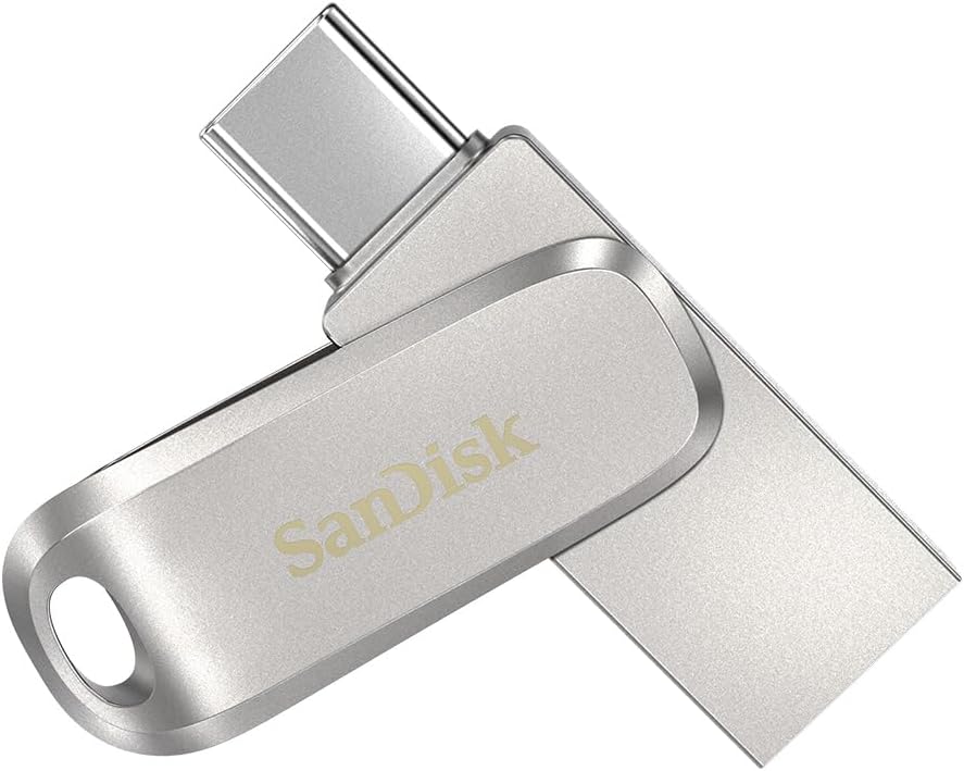

I have been using flash drive by SanDisk with USB-A and USB-C. It works fine between our BraX3 phone and a computer:
