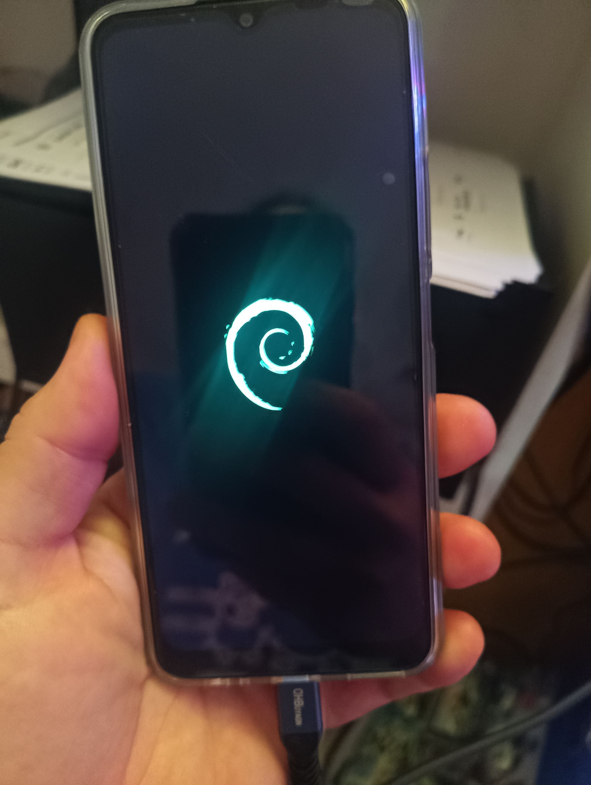

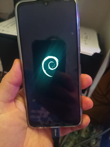

Still grinding towards Droidian. Had some small progress getting newer preloader back in place of the deprecated non-functioning preloader. Maybe could have had Ubuntu Touch by now but my goal is Debian or bust. LineageOS was key to building image at all, other paths blocked without uart.

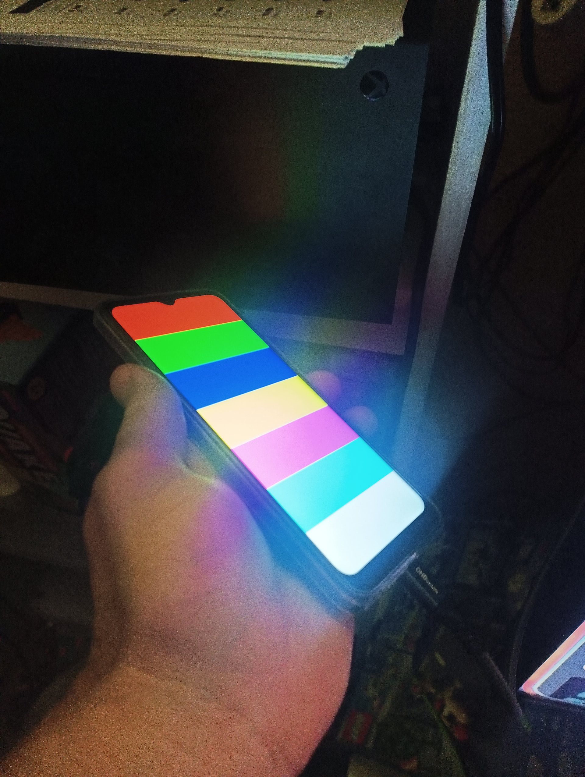

Great Progress. Droidian running and first successful test pattern on display. Hopefully get UI up today

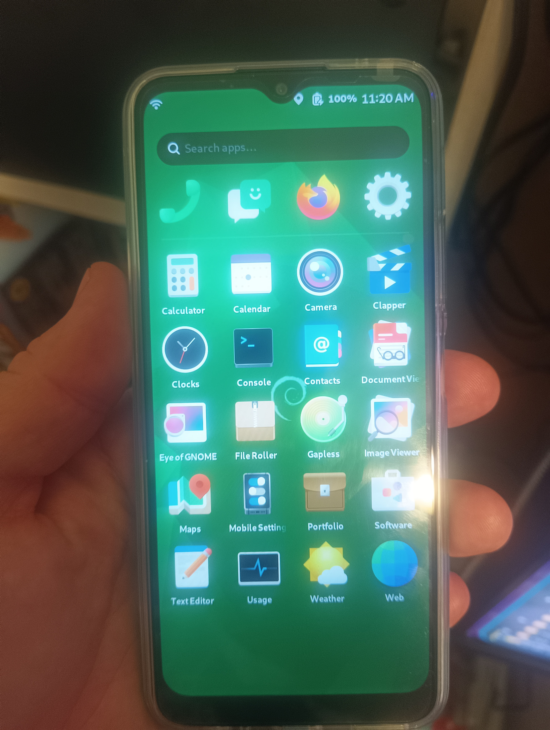

Just got touch and wifi working in Debian (Droidian)
Sound and volume control working. Video playback was getting messed up by the audio playback before audio fix- now both working.
Made first call from Droidian. Still making progress

sms is now working. recompiled the messaging app to include deleting messages. not sure why that wasn’t an option before but I needed to clean up test messages anyway. “move to downloads” option for message images moves them into the downloads folder and removes them from the message app/directory also delete really deletes. Also added nemo file manager so with Portfolio that makes two different file managers. Portfolio wasn’t working when I added nemo but both good now.
