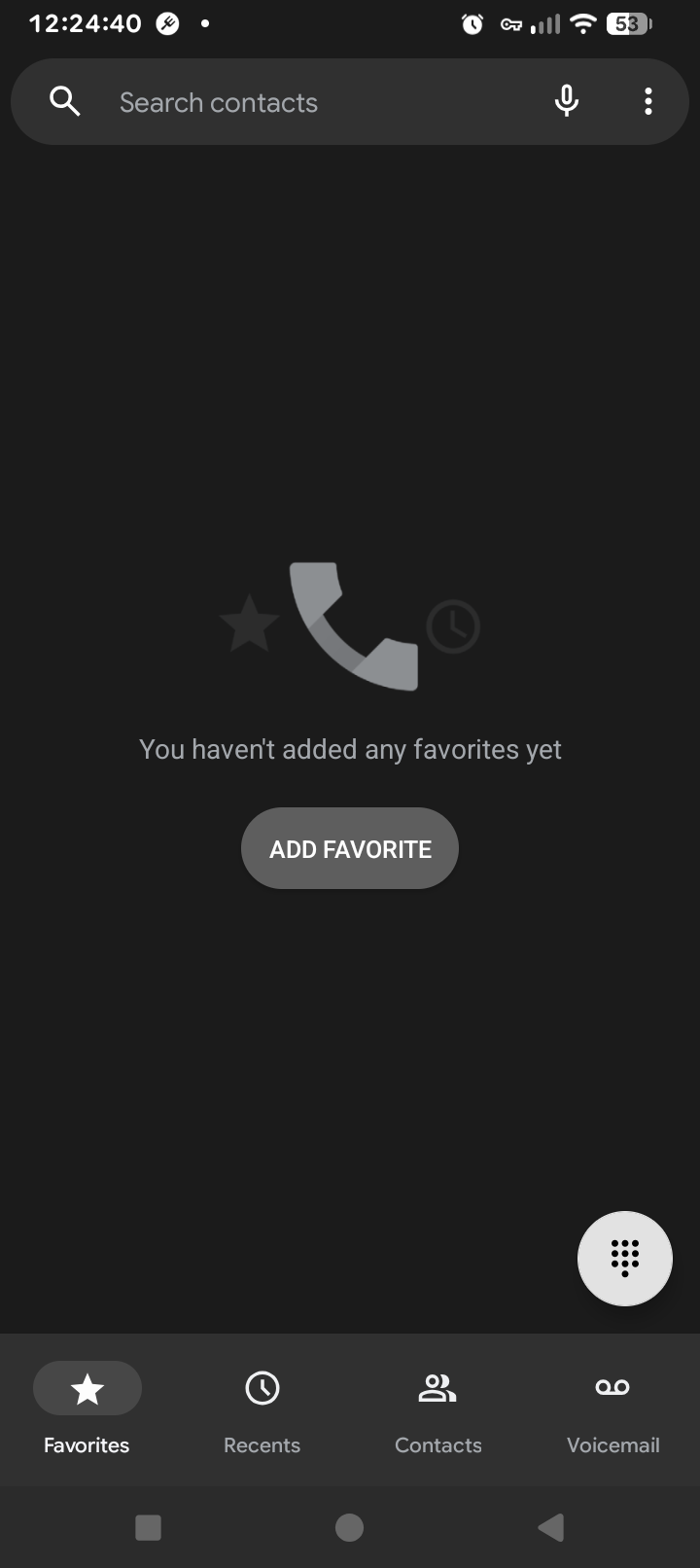

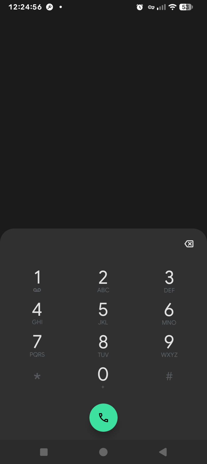

@Plamen @tech-support Updated iodéOS last night to 7.7 on Brax3 phone. This morning, I made a call to another Brax3 phone which also uses iodé but I do not know which release version.
After just over 1 hour call duration, neither of us Brax3 phone users were able to end the call via the phone app, as the app itself was no longer displayed, not even by pulling down the notification panel at the top of the screen. The caller on the other end of the call ended it by powering down the device.
While we were still connected, I reopened the phone app attempting to end the call, but the ongoing call was not displayed or in any way available. I attached these screenshots to show what options were available during this bug.
I have no way of knowing whether the bug was an O/S, phone app, or device hardware bug, though I would certainly doubt it was hardware related as everything else functioned normally.
