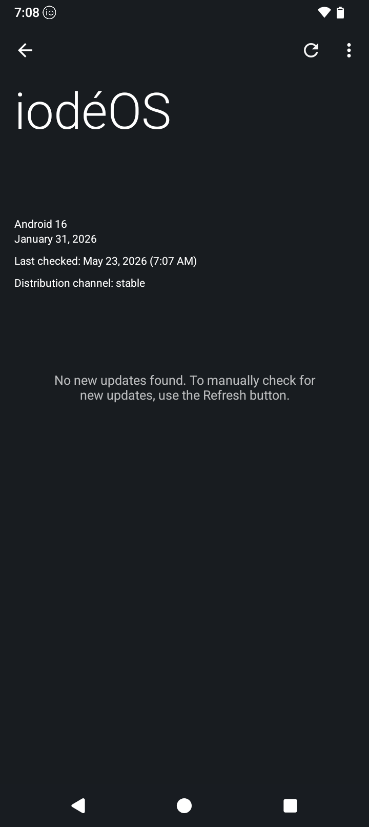

Updated to 7.2 now there is no option to update further. I have been able to verify this with another new Brax3 that has not been used.
After getting to 7.2 options to update further absent.
Reboots and multiple checks in Iode news and the “Updater” app show nothing.

I am having the exact same issue, I’m at 7.2 and when I run the Updater it says I’m up to date. It’s almost like the Updater is not functioning properly. Ideas?
