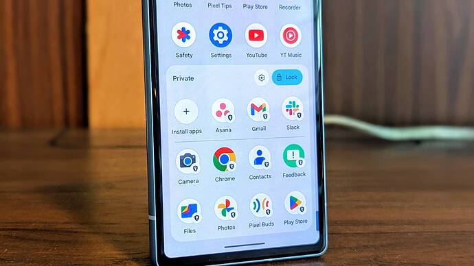

In the Settings app on iodeOS on your Brax3, under “Security & privacy” there is an option called “Private Space”. This Private Space says it’s to keep private apps locked and hidden. On the setup page it claims that you can “Hide and lock private apps in a separate space. Use a dedicated Google Account for extra security.” Also there’s a proviso that “Apps stop when you lock your space.”
In my mind this brings up a few questions. Aside from putting banking and financial apps in the private space for extra security, what about using apps that require a Google account log in? To add context to that question, it is common knowledge in privacy circles that if you don’t want Google to track you, then you shouldn’t install and log into any apps that require a Google log in. Otherwise, as Rob puts it, “You’re Zucked.” They can track you. However, this private space feature specifically mentions logging into a Google account, and that apps are stopped and won’t run in the background when you lock your space. Does this mean that apps with trackers will track you when the private space is open, but then stop tracking you when you lock the private space, or is that false?
Does the private space allow us to use, for example, streaming apps that definitely track you, or Canva, or the Amazon shopping app, but shut down the tracking when you’re done, OR does private space offer a false sense of security where that is concerned? Are you still opening yourself up to being spied on by installing big tech apps to private space, or is there nuance to the use of private space where the spying is restricted to while it is open?
Speaking of Canva, do photos saved to private space stay on private space and become un-viewable when it’s locked? Or are photos still saved to the general memory, can be accessed in and out of private space, and can be used for making a photo album in Canva?
The private space works similarly to creating a different profile, if you’re familiar with it.
Basically this allows you to create a different isolated environment, where you can install apps. It allows you to:
  • limit access of apps from your main environment to data in the private space and vice versa.
  • allows you to add an additional authentication required to access your private space;
  • allows you to use multiple accounts of the same app;
  • also allows you to “hide” notifications from apps installed in the private space, and access those once you access the private space.
If you can benefit from any of the above, using private space is a decent way to achieve your objective.
The message that it’s more secure if you log in to your google account, is a message coming from AOSP. I wouldn’t follow that advice.
