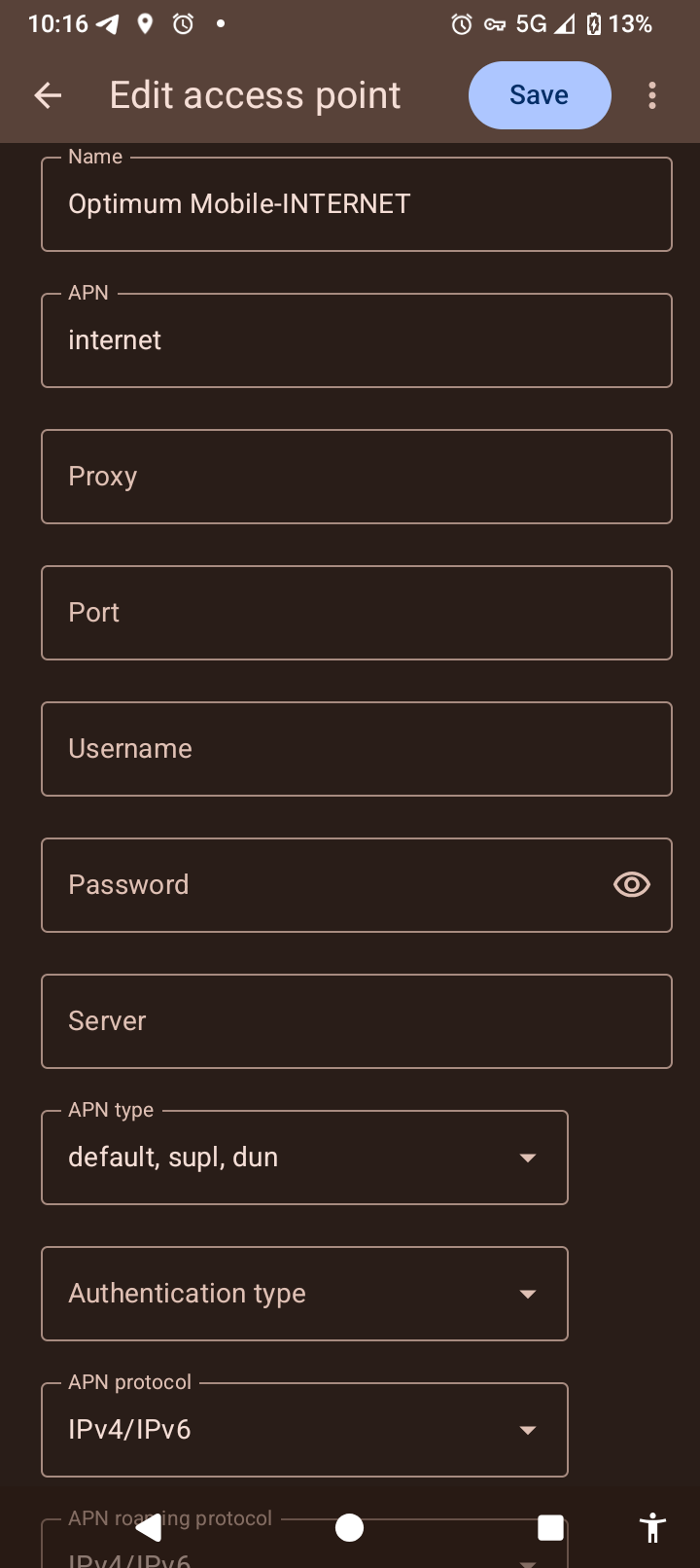

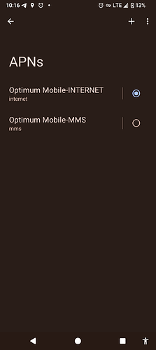

Hello, without spending too much time on my story so far. What is the definitive answer to receiving picture messages and group texts on Optimum. Nothing works for picture messages and group texts for me. Optimum took one look at my IMEI and said no service could be offered. This is obviously wrong because I can make phone calls and simple text messages. Attached I have a screenshot of my APN settings that allow for calls and simple text messages between one individual. Can you please reply with a screen shot of the correct settings for full functionality. No one will help me at Optimum and AI generated answers are wrong too.
I randomly clicked on that, Optimum Mobile APN Settings for Android and iPhone 2024 - 3G 4G 5G LTE Internet Setting

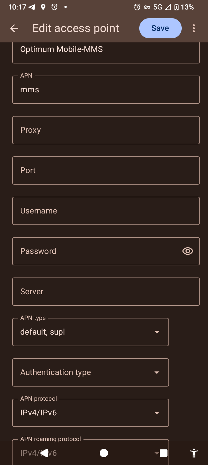

As I can see he creates 2 APNs, 1 for internet and 1 for MMS

Try to replicate those settings and update us.

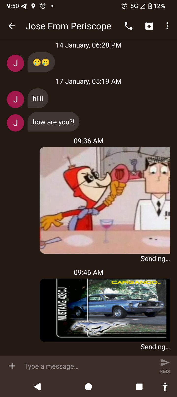

George, images are still stuck sending. After trying these settings from the link you shared.

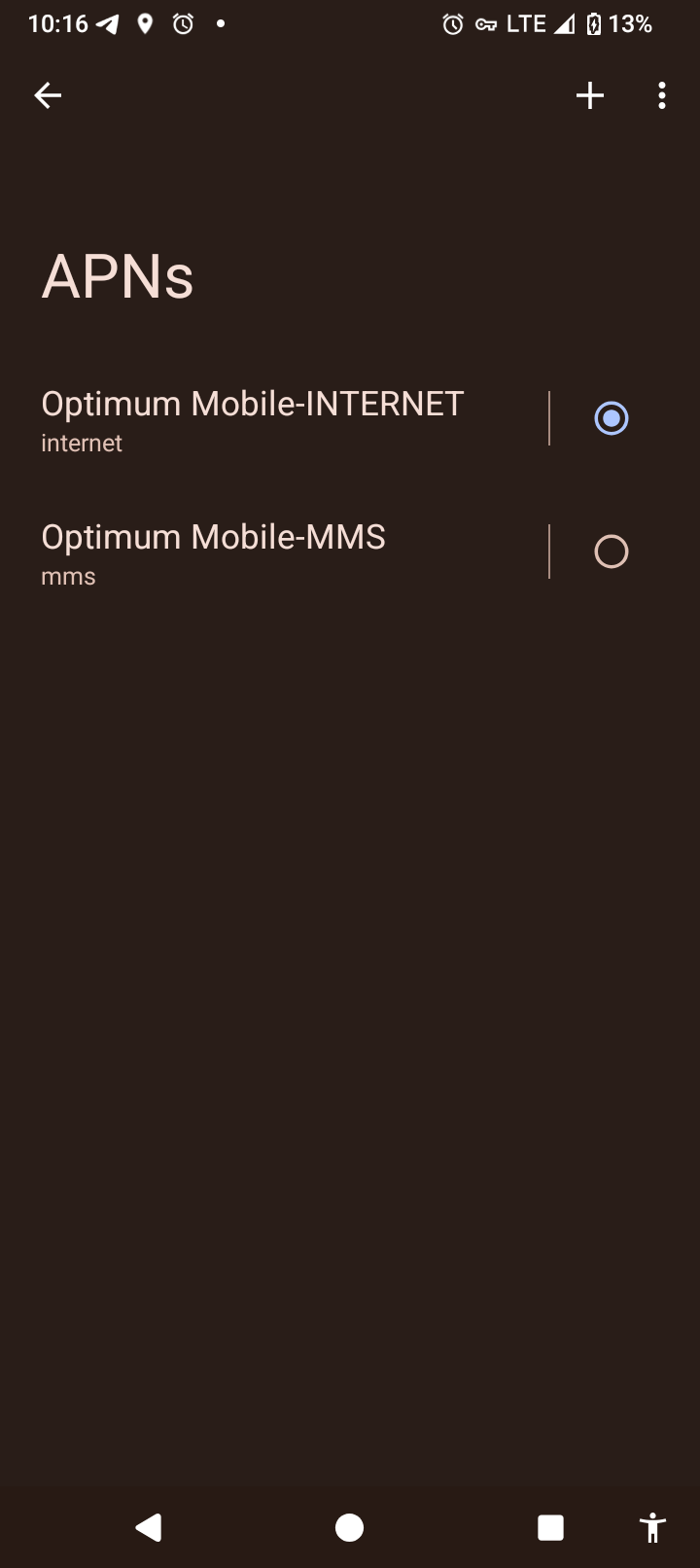

Screenshot from 2026-01-19 10-10-10
try again with the MMS APN selected

Do you get a toast with an error code while sending messages?
