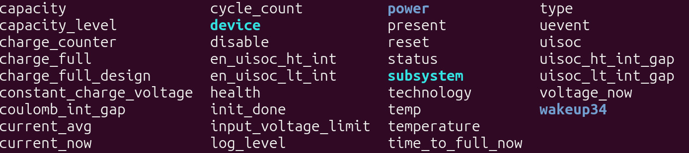

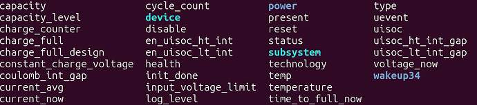

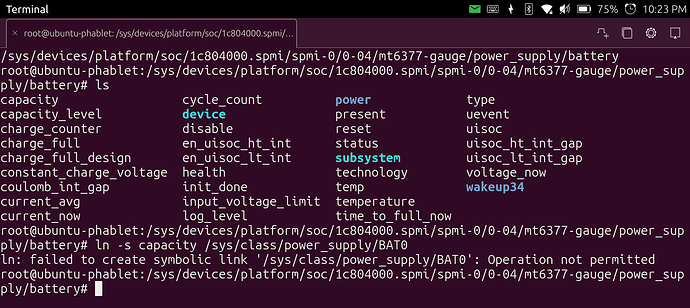

That file doesn’t exist on the BraX3. Instead there is a file called battery there that is a link to ../../devices/platform/soc//1c804000.spmi/spmi:0/0-04/mt6377-gauge/power_supply/battery which is a directory with a lot of charging files. I attached a screenshot.
Maybe that app is looking for BAT0. Any idea which file here that would be linked to?

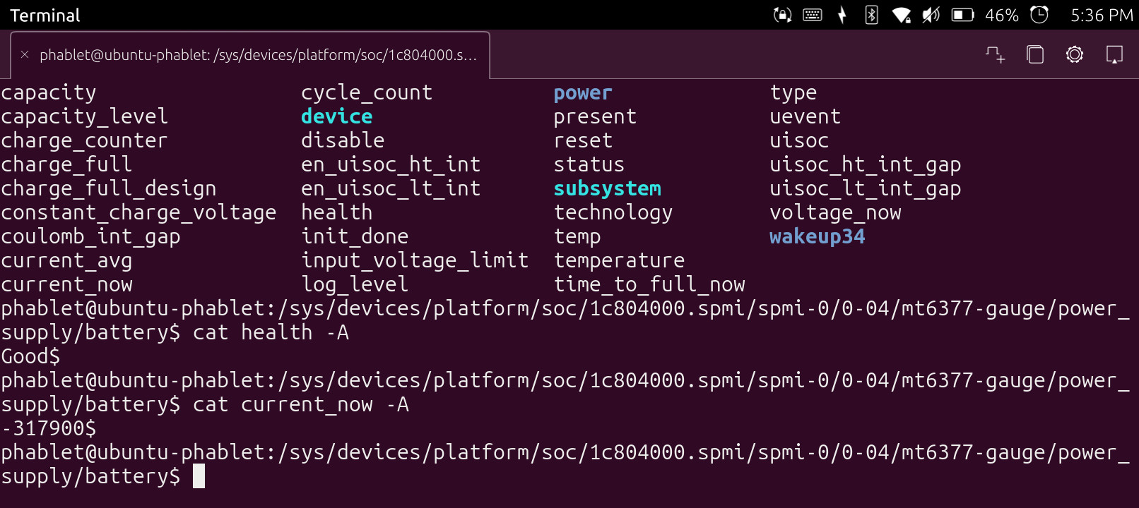

Do a cat for each file to see what settings they contain and you may be able to right in the file and adjust the charging level.

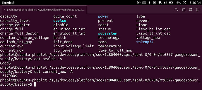

I’m using cat -A to see everything but it doesn’t show much. Usually a number or good. What am I looking for?
So each file controls one thing. It could be the capacity_level file but I don’t know what units it could be using, it could be volts, percent or some arbitary unit. This value could be writable, you can only know if ou write into the file like with the dd command and then test the function.

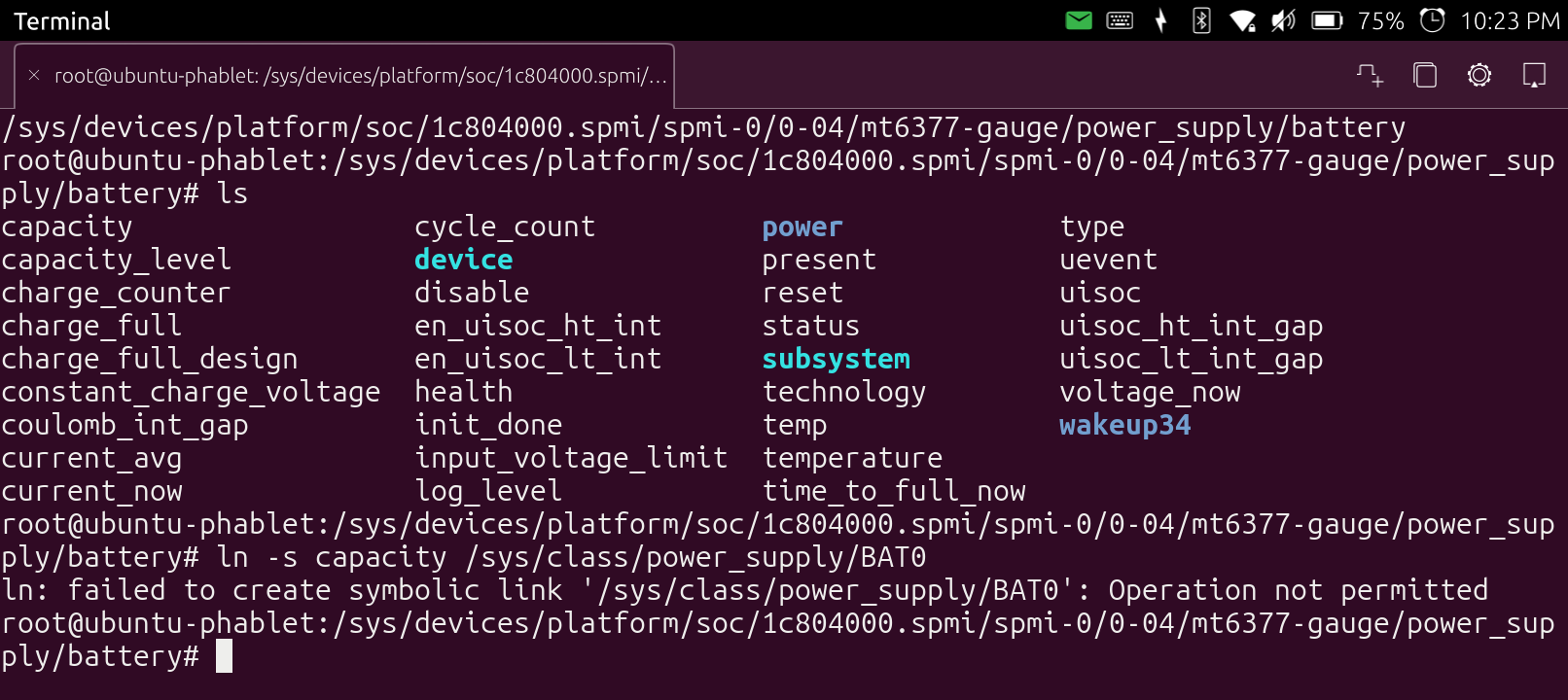

I found the file with the current charging percent. That would make sense that’s what the app uses since that is the only unit it shows. The file is called capacity but unfortunately even the root user is not allowed to write in /sys. I uploaded another screenshot showing that.

It’s a different su command or something similar that can write in there, I’ll have a look, those are actually settings in the kernel, on Pinephone you flash firmware that way but I also remember turning on LEDs.
The proper way to write into those files is the echo command, maybe you can do it by changing your identity with the su command but Ubuntu Touch is already more restricted than regular Linux.

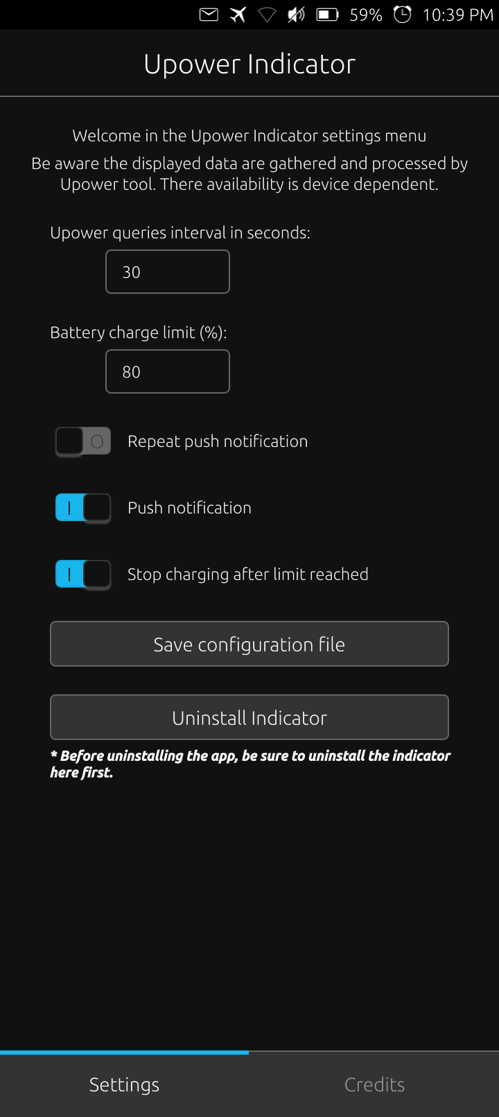

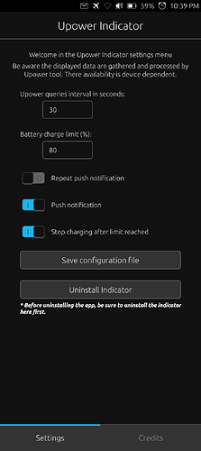

This is the app that was talking about…it looks like it would work but it keeps on charging past 80%!

My UPower Indicator app updated yesterday to include MTK devices. I think that’s why that stop charging prompt turns green now where it used to stay gray. This app is still being worked on. I will email the developer.

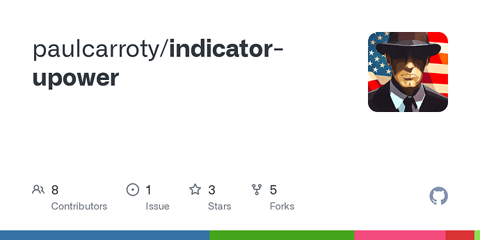

This is the active place for the developer:
