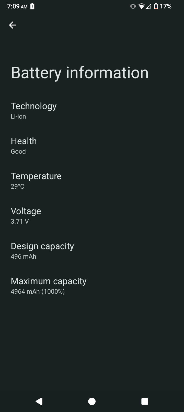

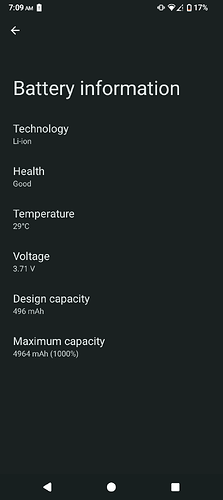

I’m also very curious what it means that the “Battery information” says that the “Maximum capacity” is 1000% of the “Design capacity”. That doesn’t make a whole lot of sense to me. But that’s just curiosity; the battery seems to be working great.

For some reason, iodeOS reads the battery capacity as 496 mAh instead of 4960 mAh.
Not sure why. We identified it in early testing and established it doesn’t actually affect battery performance. So it’s a minor impact bug that will get resolved some day.
