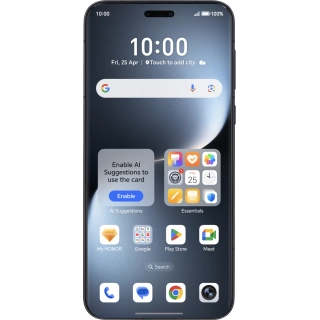

To get your data working on your mobile you can probably follow the steps from Vodafone’s help pages on this device, from steps 5 through to 25 should be the same as for the Brax3.
Although it wasn’t the same, I was able to use the general approach to dig into the phone and choose the right setting for this pre-pay SIM - after a few dud choices.
So yes, thank you - phone is fully operational now.
