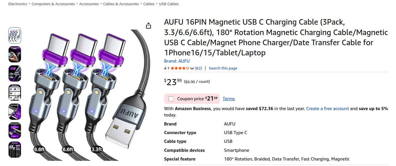

There’s a chance of damage when using a metal tool to clean the contacts. I actually use a magnetic type C cable. The type C plug stays in the phone the whole time, and the magnetic cable section just self centers and pops on when you need to charge. This keeps dirt out of the port. I’ve been using these for years, on my old Nexus 6, S8, S22 and now my Brax 3 with no issues. I imagine there is a chance of something shorting out the out pins on the type C portion, but they are slightly recessed and have never been a problem for me. It made it super easy to pop the charging cord back on the phone when I was in and out of my work truck 30 times a day
