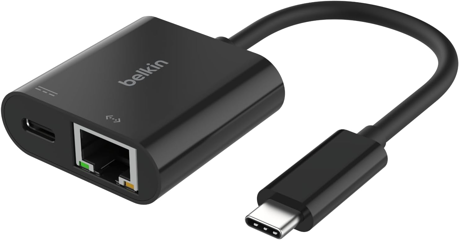

My BraX3 only connects to my small travel router but not to my larger Netgear routers. I have read this is a common issue but it seems u are not using a router. What I do to get higher speeds is use a long ethernet cable with a USBc adapter like this:
