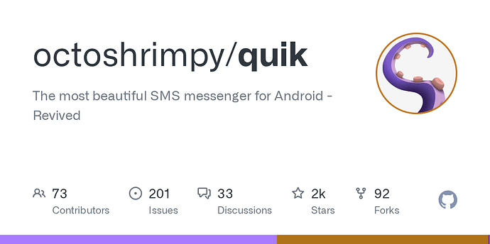

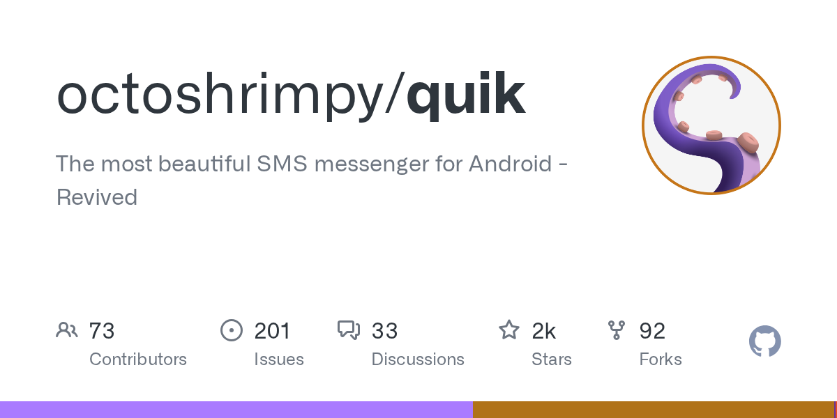

QKSMS hasn’t had an update since February 2021. Consider trying out QUIK, a currently-maintained continuation of QKSMS.
Good to know. Thanks
