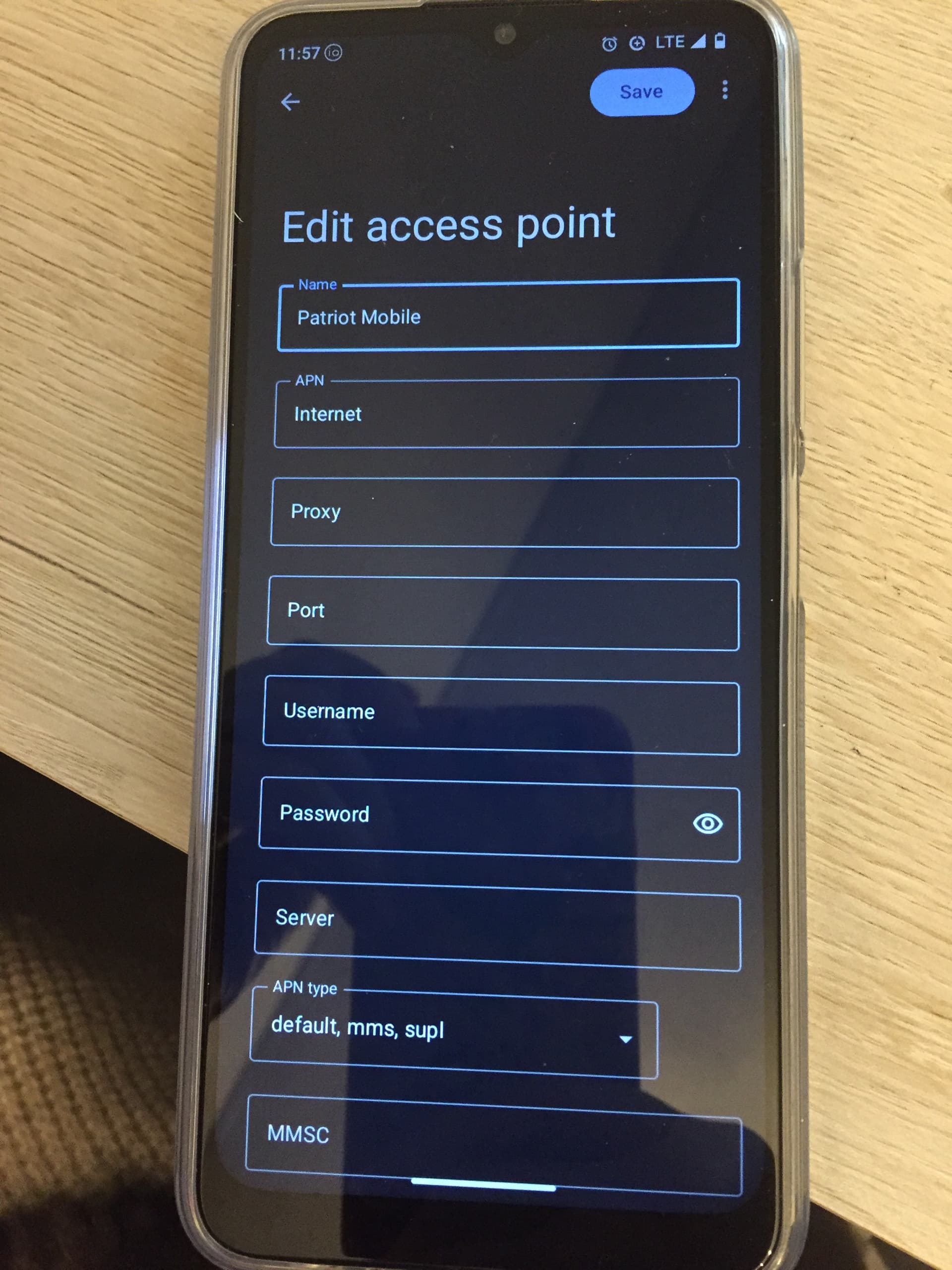

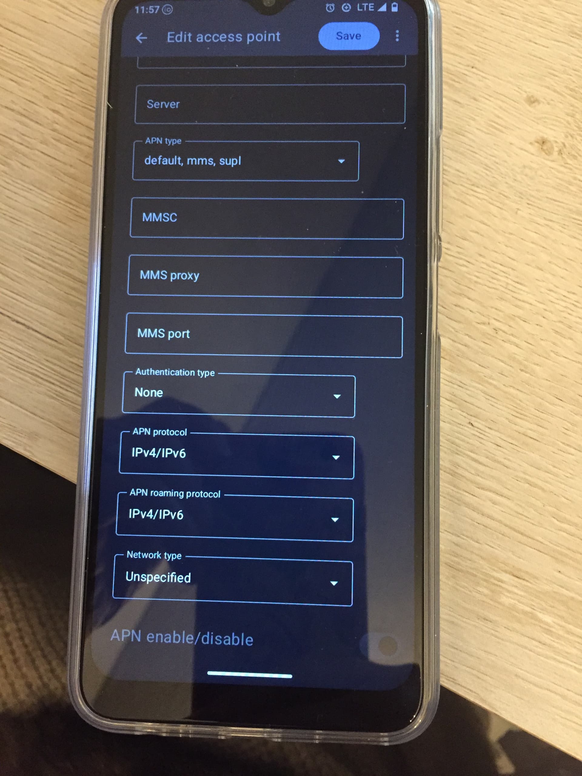

I already have one listed, but I tried to add another and have the same options and issue not being able to enable APN in the Edit Access Point screen. I am missing some of the options listed in the config you sent, and have some options that are not listed. I’m trying to get a photo to send you, but since neither of my PM phones can send to email I’m having to jump through some hoops here. Stand by pls
Here are pics or what it looks like when I add a new APN
Just for comparison, this is my settings for T-Mobile. Yours may vary since you are using a MVNO..
