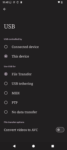

That is normal. Instead of changing the Control to the Mac, move further down the list to “File Transfer”
Usually, at least on mine, when I connect the device to a computer it starts to charge. You then need to “allow” file transfer from that same menu.
That should be it I think.
Thank you @xancudo for trying to help me. Yes, the phone starts charging when I connect it to my Mac with a USB cable. I was able to choose “This device” and check “File Transfer” on my Brax3 as illustrated in your image. The Mac does not show the phone in the Finder menu and there appears to be no way for the phone to tell the computer which files I want to transfer. Since Macs are big proponents of highlight and drag file movement, I was hoping to highlight my music files and drag them to the Brax3 icon in the Finder window to get them transferred. I searched for a way for the phone to find the files on my Mac but couldn’t find anything. Am I missing something? Any other suggestions? TIA
