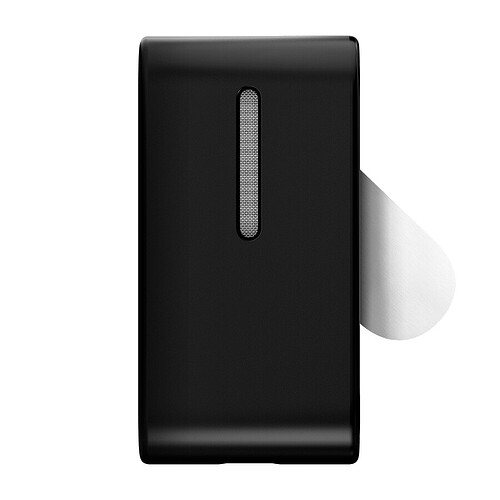

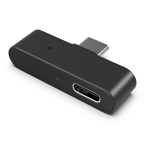

“Oticon hearing aids can also enable you to have hands-free calls and stream music and audio to your hearing aids from Android devices. To do this directly, your Android device must support Bluetooth® LE Audio or Audio Streaming for Hearing Aids (ASHA). Select Android phones with Bluetooth LE Audio can also enable you to have hands-free calls. If your device does not support LE Audio or ASHA technology, you will need an accessory such as ConnectClip or Easy LE Adapter to enable audio streaming from your hearing aids.”
I suspect BraX3 and iodéOS do not have Bluetooth® LE Audio or Audio Streaming for Hearing Aids (ASHA) by default (@plamen if you see this can you confirm), so you will need an accessory: ConnectClip or Easy LE Adapter.
