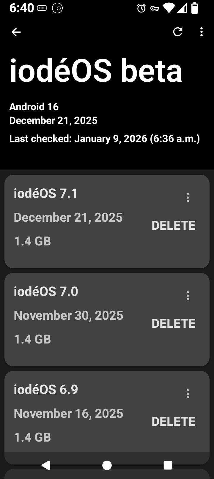

I’m feeling good about my Brax3 ph and know it’ll get way better with the present bugs being fixed via fantastic future updates/upgrades, except mine won’t update from OS 6.9 since a few weeks ago, sad to say.
I easily updated the ph’s iodé OS twice with no issues prior to the 6.9 OS update and successful install, but ever since then, when I go to check for the latest OS update, a pop up says ‘the update check failed. Check the internet connection and try again later’, all while the ph has what appears to be a fair to good WiFi signal strength, but no data is available. Being that is the problem, how come ? the network details are, transmit link speed 42 Mbps, and receive link speed 29 Mbps, but the up/down data load icon at top of scene, randomly/momentarily appears, and shows 2-4 kBs d/l, but 0 kBs u/l speed, :thinking::rightwards_hand:t3: why is this so ?

I did lots of differing thread reading and I found nothing :roll_eyes: to help me sort out the Update Checker failing issue, when ever for the last month when I checked the checker for the lastest and greatest. It turn out to be a simple/easy fix, as I always thought it will’ve been.
I did a couple of different system resets, and third time lucky after resetting app preferences, she’s now back working normally, proven with the 16 Nov iodéOS 6.9 update has just been successfully installed :+1::wink::+1:
Ps. Very very happy about that above easy fix worked, mainly because my Brax3 has now got Android 16 with iodé OS 7.0 :+1::slightly_smiling_face::+1:
I’m told there are updates for 12/25 and 12/27 but they don’t appear…
How did you install the latest update? I still have the original version on my phone. I can connect to wifi but the installer will not work. I’m not extremely tech savy. thanks.
