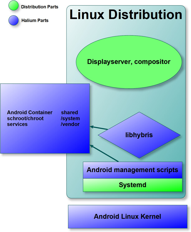

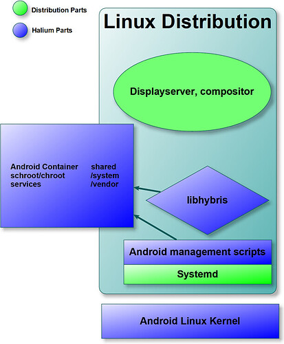

As you can see in this diagram at halium.org, the hardware abstraction is complicated and demands an Android kernel and various Android services that talk to Mediatek’s binary blobs, somewhere in this stack the communication with the modem is not stable, everything else happens internally inside the modem which is a 2nd computer running Linux and Android trusted environment, the modem will automatically recognize the SIM.
