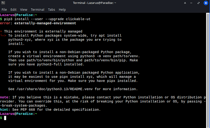

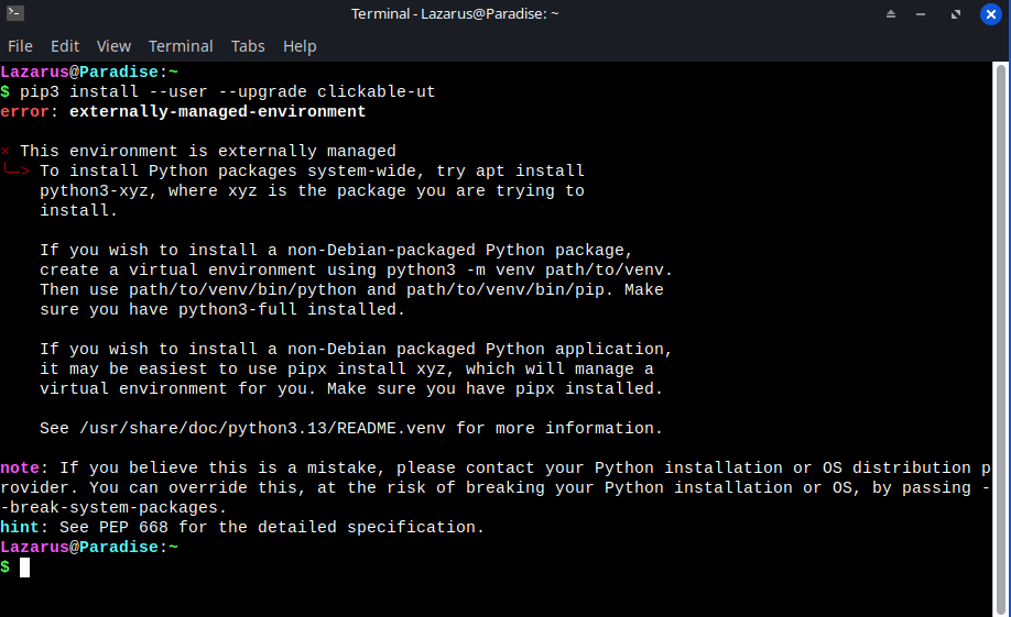

BUT the second dependency gives me this error. I guess my system is newer than that tutorial. Any ideas?
George found this for me back in February and works. I picked up with pipx on the 2nd command!
still didn’t work. No errors but wouldn’t build on this PC. It wanted more dependencies which I installed but got errors. That video assumes u have already gotten this installed. I think these directions are at least 2 years old. I’m thinking I should set up my PC with older software.

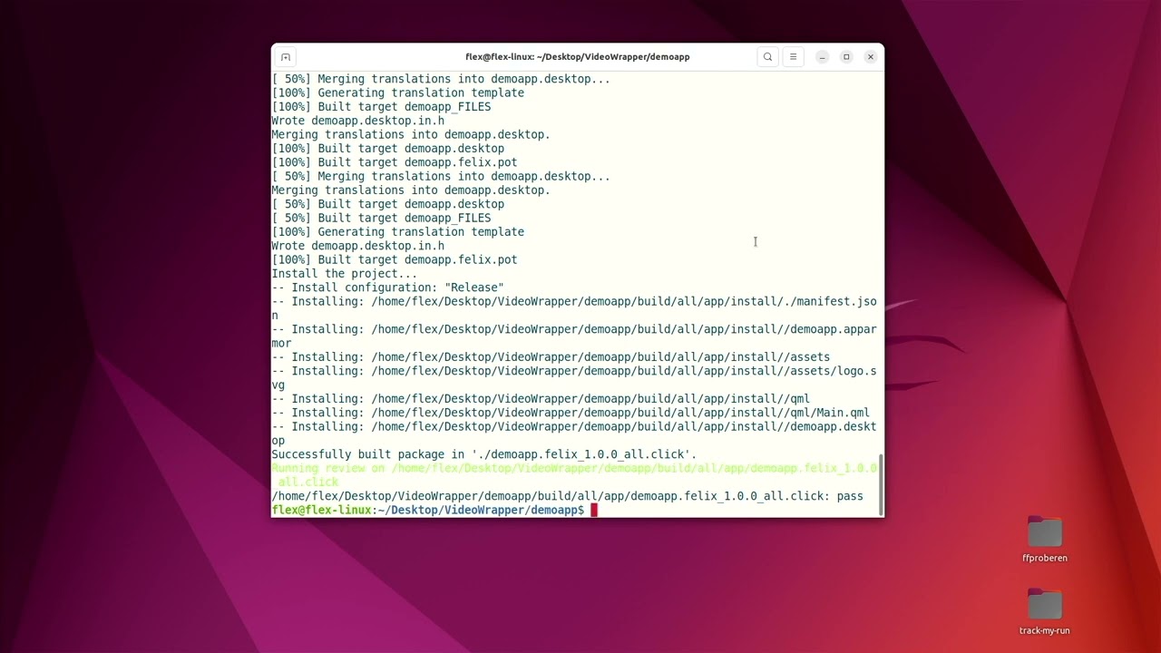

I got further by installing XUbuntu 24.04 LTS and using that to build a default clickable project. I used the the first pipx method in the above article:
I didn’t have any problems until I tried to set this up as explained at the bottom of that page. I was getting a permission issue that I could not resolve with sudo or as root. I wound up doing this and it worked:
sudo chown lazarus /var/run/docker.sock
clickable setup configures your app making workstation. To make an app continue with:
clickable create
and then
clickable build
