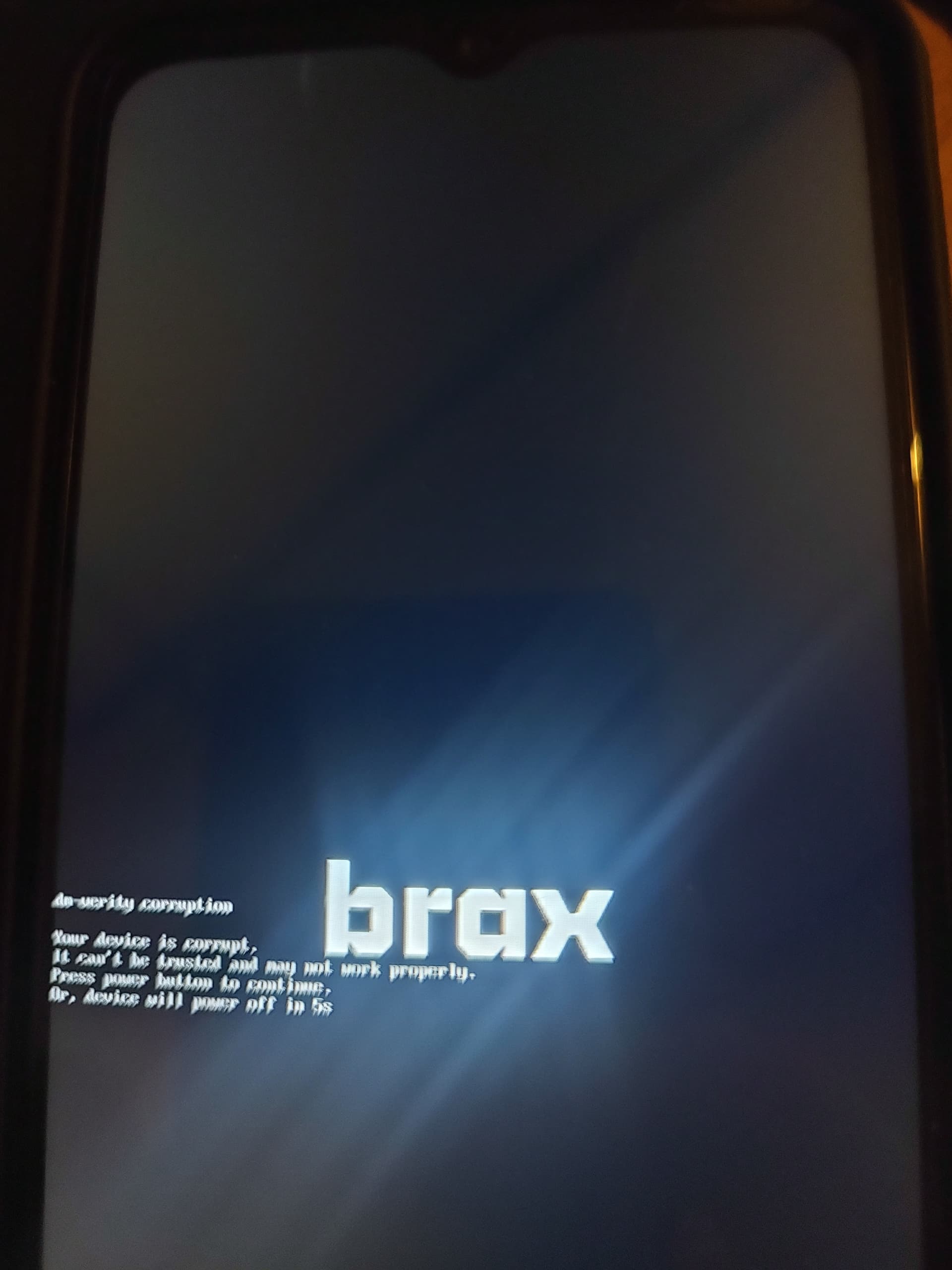

Phone warning me :"Your device is corrupt. It cannot be trusted and may not work properly "
I’ve not seen that before. What state was the device in prior to rebooting, and receiving that message?
It was brand new out of the box. Took phone set it up with PIN and Internet connection. I have Verizon mobile,so I have to wait on Mint mobile to send a SIM. After I connected to internet I downloaded the app stores (aurora, apkPure,F-Droid). Then downloaded Surf Shark VPN (paid subscription), you tube (without logging in) & ProtonMail. When I was done, I shit the phone off because I had to work. Later turned it on and the msg you see in my pic appeared. Phone stayed on for 5 seconds and shut itself off. It did this over and over. On occasion I was able to gain access, but once turned off this “Corruption” notice started up again. I re-enforceced the iOdes fire wall and that didn’t work, so I put it back in normal mode. I uninstalled Surf Shark VPN as well as m.youtube. I tried a factory reset today… no go. Tried to boot from recovery mode…no go…

I think I sorted with Heidi on a DM that it was part of applying the system update that got it stuck like this, but I haven’t seen the issue. Even if it had a corrupt update, it should just roll back to the “other slot” (standard Android practice is to use “2 slots” for read-only system update images: the newer one is put on the “other slot” and you boot from it. If any booting issues, you then “roll back” to the “old slot” and nothing has changed).
Now, if a user does manually unlock their bootloader, there is a nasty Mediatek bug (not part of our codebase at iodé or with the brax team directly either) that will corrupt the b slot so it breaks updates. But it shouldn’t break any existing install.
I do wonder if there are some cases of loose flash storage on the phone, or something along those lines. There were a few users that have had similar inability to boot (they more have “boot loops”). But in your case it really does seem like that as the problem is intermittent. temperature changes, humidity changes, etc. will cause intermittent issues with a poor solder joint, for example.
So I do think that it is a hardware level issue. A replacement should NOT take 9 months as the phones actually exist now!

I have this same exact problem, it will boot…but will shutdown when using music player maybe other apps as well. Recovery did not fix it, and Factory reset did not fix it…
If you are getting the “Your device is corrupt” message, that sounds like a hardware failure. You’ll need to message [email protected] make sure to include your order number, detailed explanation of what is happening, what you have tried to fix it

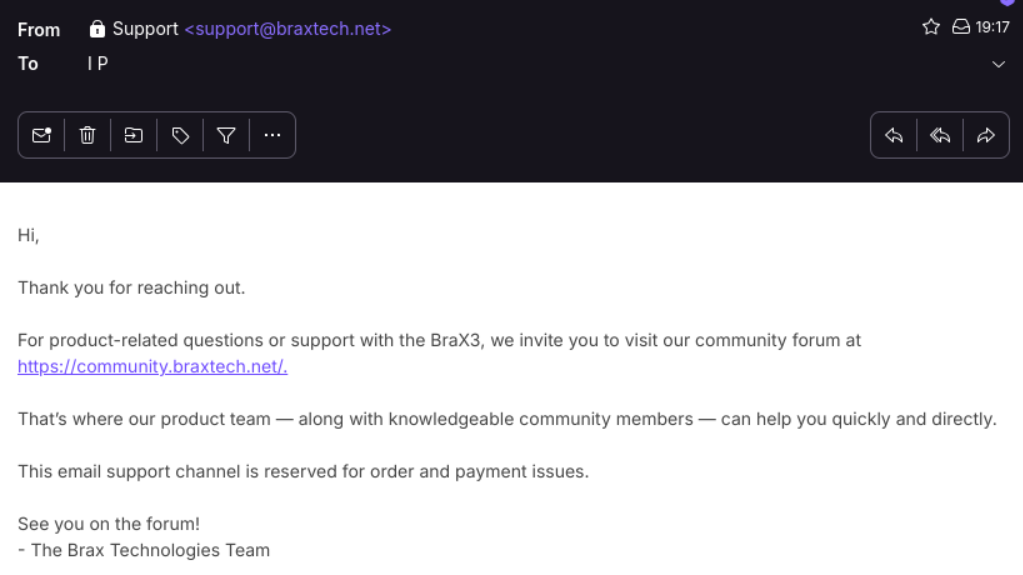

This is the answer from [email protected], sending the screenshot with “dm-verify corruption” and requesting an adress for sending back the phone. Funny???
At 27.08.25 um 19:59 wrote Support:
Hi A,
Thank you for reaching out.
For product-related questions or support with the BraX3, we invite you to visit our community forum at https://community.braxtech.net/.
That’s where our product team — along with knowledgeable community members — can help you quickly and directly.
This email support channel is reserved for order and payment issues.
See you on the forum!
  • The Brax Technologies Team
Brax Technologies
Be patient. I believe that is an automated response, as others have gotten the same reply initially.
I am aware of at least one person who has eventually gotten return instructions
I contact support about this issue but they send me back here,
Contact @plamen on here, and he should be able to assist. You def should get a new device though. I know they have done that for others as well.
This was my experience, I am now waiting for my replaced.
Hi, do you have a confirmation form Brax team that they will replace your device? could you share who you contacted there?
Thanks a lot.
zvzoh-Support has indicated that it will be replaced.
You can contact support at [email protected], you may get an email that I believe is automated that may seem to direct you elsewhere, however they will contact you after the first response and they will help you with you issue. If it needs to be sent in for replacement support will give a RMA and how and where to send it. Support was very quick and helpful.
Support says they will respond within 10 days of receipt, I assume that is 10 business days. I believe you can get a refund or replacement, I like the Brax3 and asked for a replacement.
I have sent mine in and they have received it, support confirmed that it was received. So now I am waiting to find out if it will be replaced, I assume that it will be. It’s been less than 10 days so I am patiently waiting.
This has been my experience so far.
Yep, received the email today. It will be replaced.
