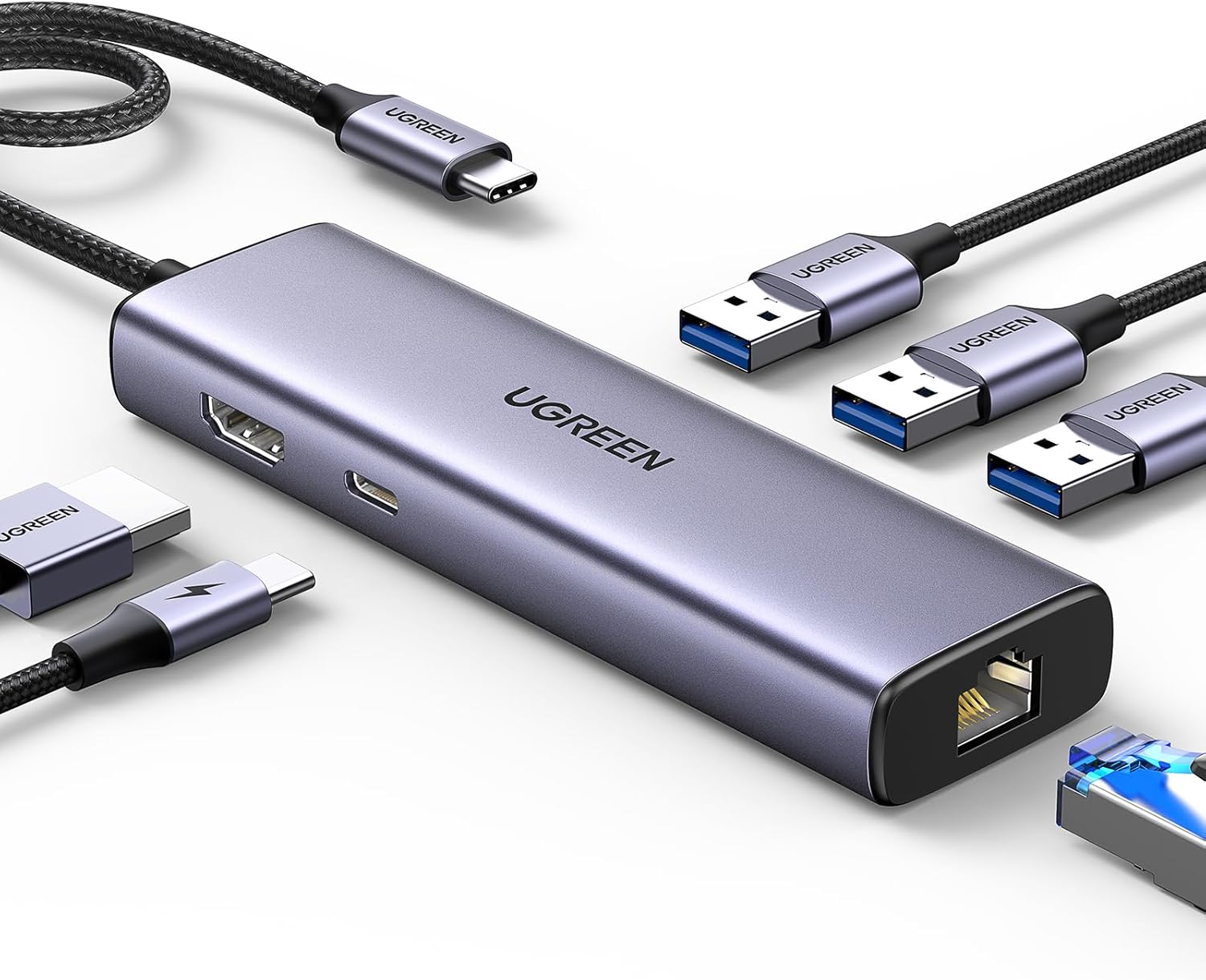

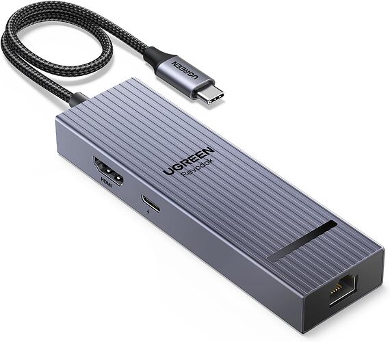

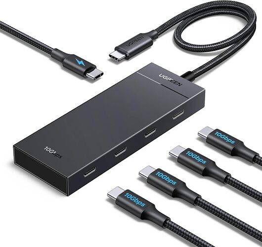

The kind of hub I’m looking to use with Brax 3 is something like the following options:
The first option allows Ethernet OR power (not both) on Brax3 (I tested it myself), and will not work on iPhones older than the 16/Pro (also tested it myself). Third option above appears to be geared towards 16/Pro as well… so I’d presume similar results would follow.
