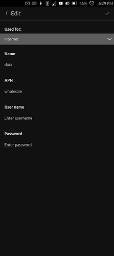

The given APN settings in Ubuntu Touch are not enough
I messed around with my Sim card today in the Ubuntu Touch BraX3 and got it to recognize my card so I could then take screenshots of the given APN setting. U can only see these if the Sim card gets recognized. It seems that u can only have 1 card in the Sim/micro SD tray for Ubuntu Touch to reliably set things up. So don’t put the micro SD card in the tray.

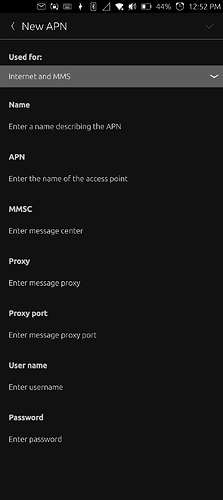

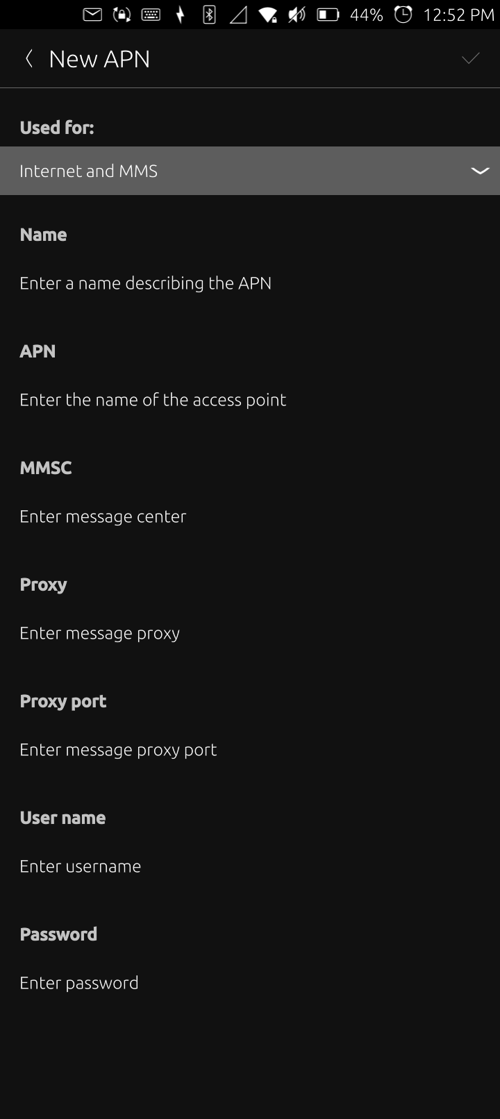

I use Mint Mobile. What I noticed is that there are more settings given by Mint Mobile than there are settings in the UT menu for APN settings. Is there another way to enter the needed APN settings? Maybe by CLI?
This is the screenshot of what u can fill out for APN settings in UT:

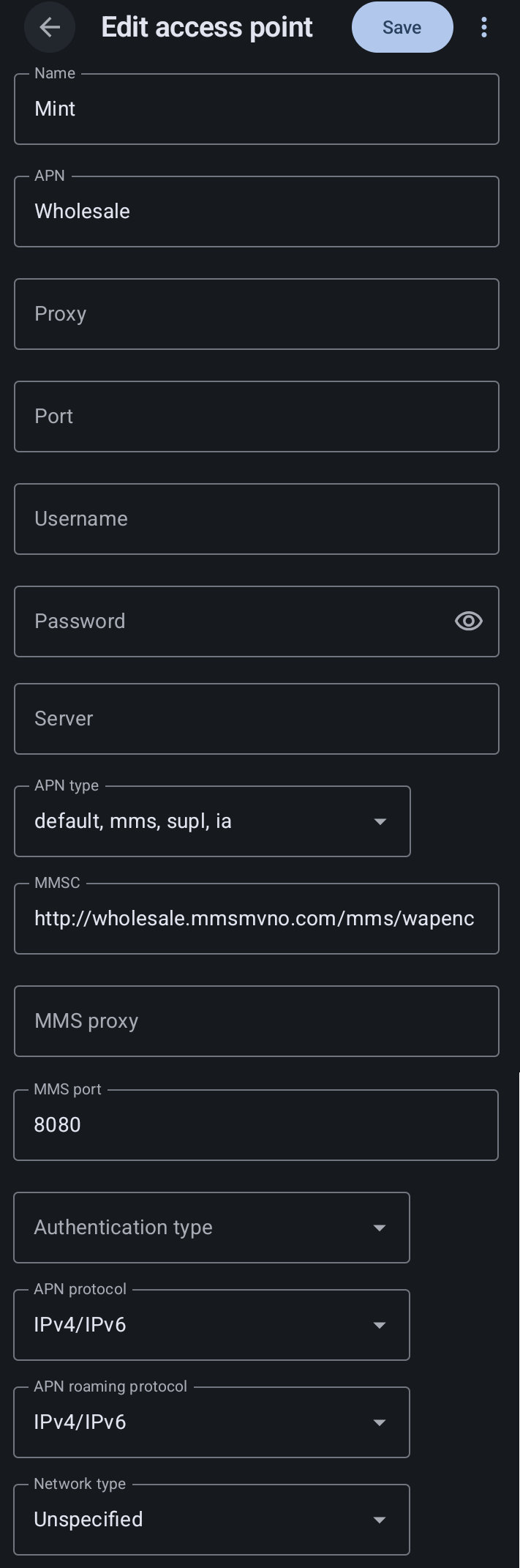

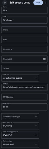

This is what my other BraX3 running iode’ 7.3 uses:

The objective is to have internet connection and calls, SMS/MMS. The settings missing are mostly the default values. They should be stored in some JSON file somewhere. Github has many related open and closed issues though they are quite old.
Almost there! I got MMS and data (internet cell data) working by following the iPhone instructions that Mint Mobile gives:
https://www.mintmobile.com/help/how-to-configure-iphone-settings/

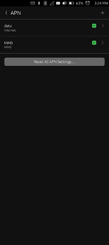

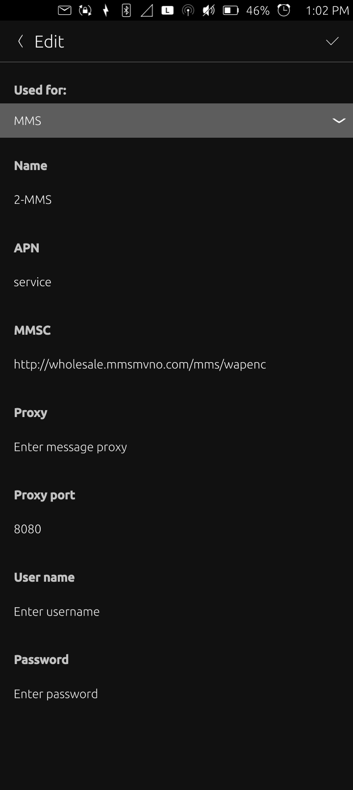

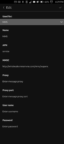

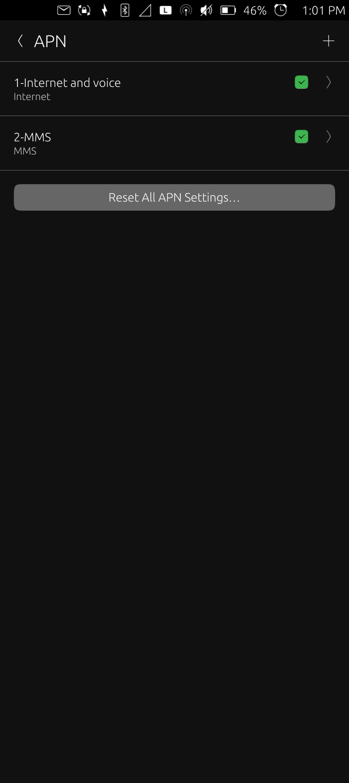

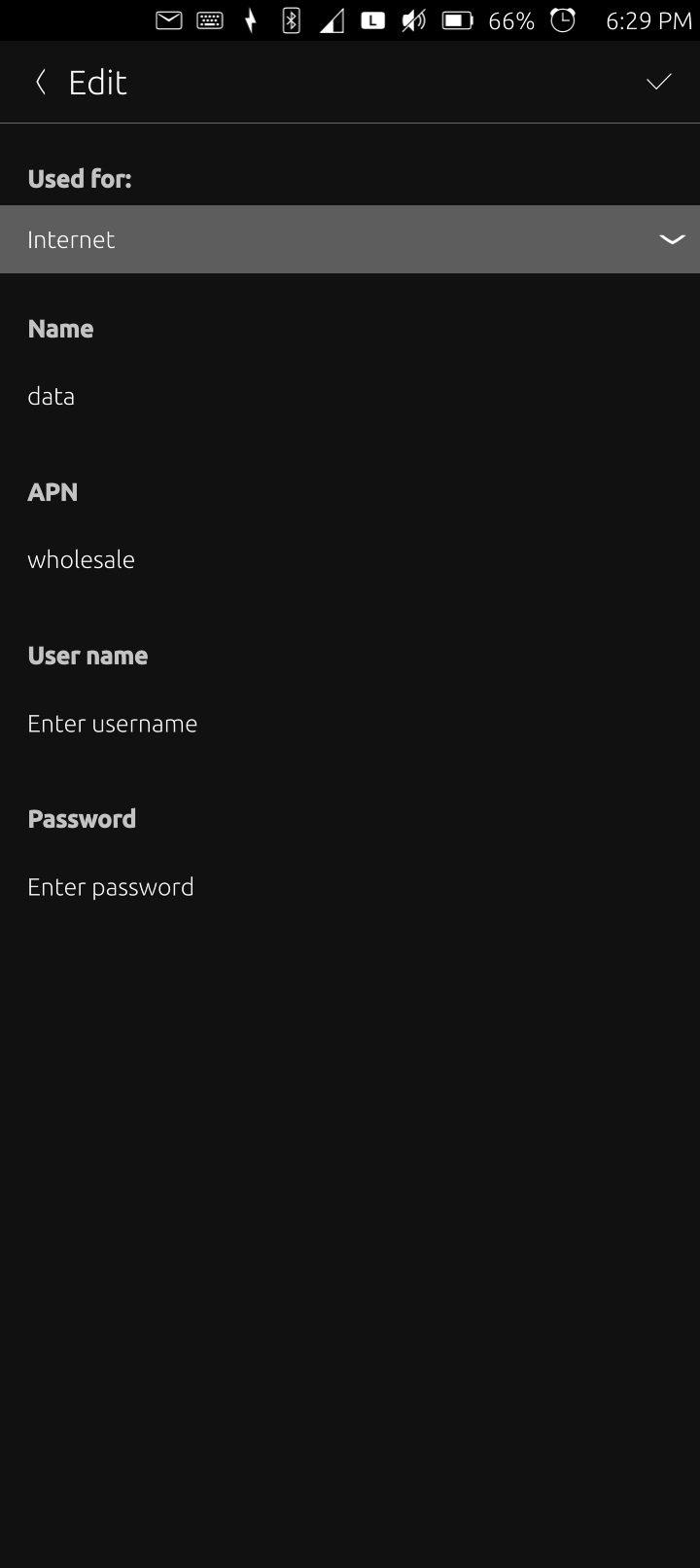

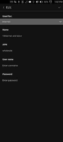

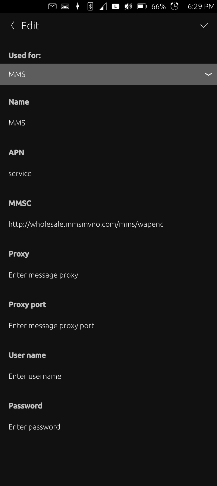

So now I have 2 APNs working at the same time. I’m not sure why voice isn’t working as VOLTE is checked. It won’t let me setup an empty LTE APN. Here are my 2 APNs:

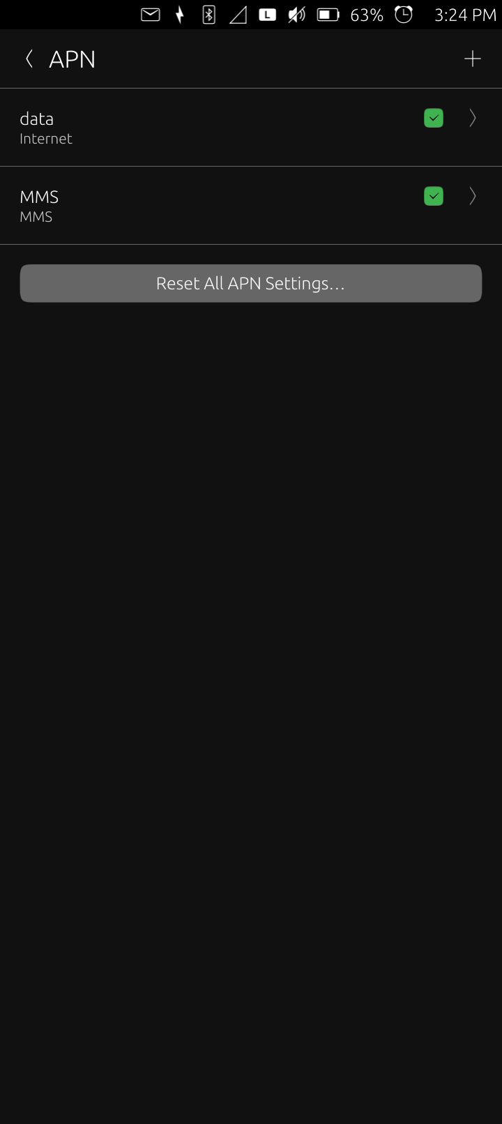

I figured something else out about the APN settings. The order matters. I reset the APN settings because I messed it up…that’s what I do I mess things up and then fix them! Fortunately I had the screenshots here to guide me but I was getting no internet. I just resolved that and took screenshots on the order of the 2 APNs. Moving them isn’t clear. I think the last edit goes up top but this is what u want for internet data and MMS to work:
Voice doesn’t work. VoLTE is enabled so if it was an iPhone then voice would work. In Android u would need to add this to APN type:
default
Ubuntu Touch is missing that field!:frowning_face_with_open_mouth:
OK, UT mixed up the APNs again on reboot and isn’t detecting the SIM card at times. Make sure the SIM tray is empty each time it starts and then insert just the SIM card in the tray after logging in. This is what I’ve been doing the entire time but UT failed to detect the card so I had to power down, empty the tray and try again-the next reboot worked.
So, then I was able to see the APN settings and it mixed things up. The internet data field seems to have to go first so I put numbers before each APN and that is working…for now. I also filled in the proxy port entry for the MMS APN in hope of getting voice to work. No voice still but here are some more screenshots:
