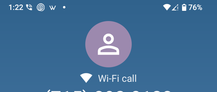

I read somewhere that another user had tried setting up WiFi calling and had not had luck. The poster mentioned that it was critical for them especially in areas where there is poor cell coverage. Has anyone managed to get around this issue i.e. getting WiFi calling to work on Brax3
I have T-Mobile and both WiFi calling and visual voicemail work for me

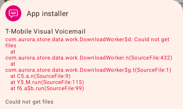

I shut the phone down and restarted. Successfully installed TLife. With VVM i get this message from Aurora:
Can you please help? Not sure if clearing cache is next step
That is still a glitch with Aurora.
Remember, they are playing a cat and mouse game with google play store to get the apps to us without an account. You can try logging out and back into Aurora store anonymously, or force close the app and clear cache and data on it, or try somewhere else like apk pure

Keep trying several times a day. Sometimes waiting until the next day or 2 resolves this issue. I was unable to install the T-Mobile VVM app for several days then it worked. Like someone said below aurora is trying to fool the google play store and I’ve had the same error before but numerous tries and days later it works.
What you can do to reset Aurora store is long press the app icon > app info > force stop. Then storage and cache > clear cache and clear storage.
Then you can open Aurora store again

I didn’t make any real change except to the Aurora force stop and clear storage/cache. (Thank you @guardian241 )
Not sure if the Aurora reset did it or it just worked like you said…

I did need to force stop Aurora and clear cache and storage. The VVM app installed and worked immediately.
