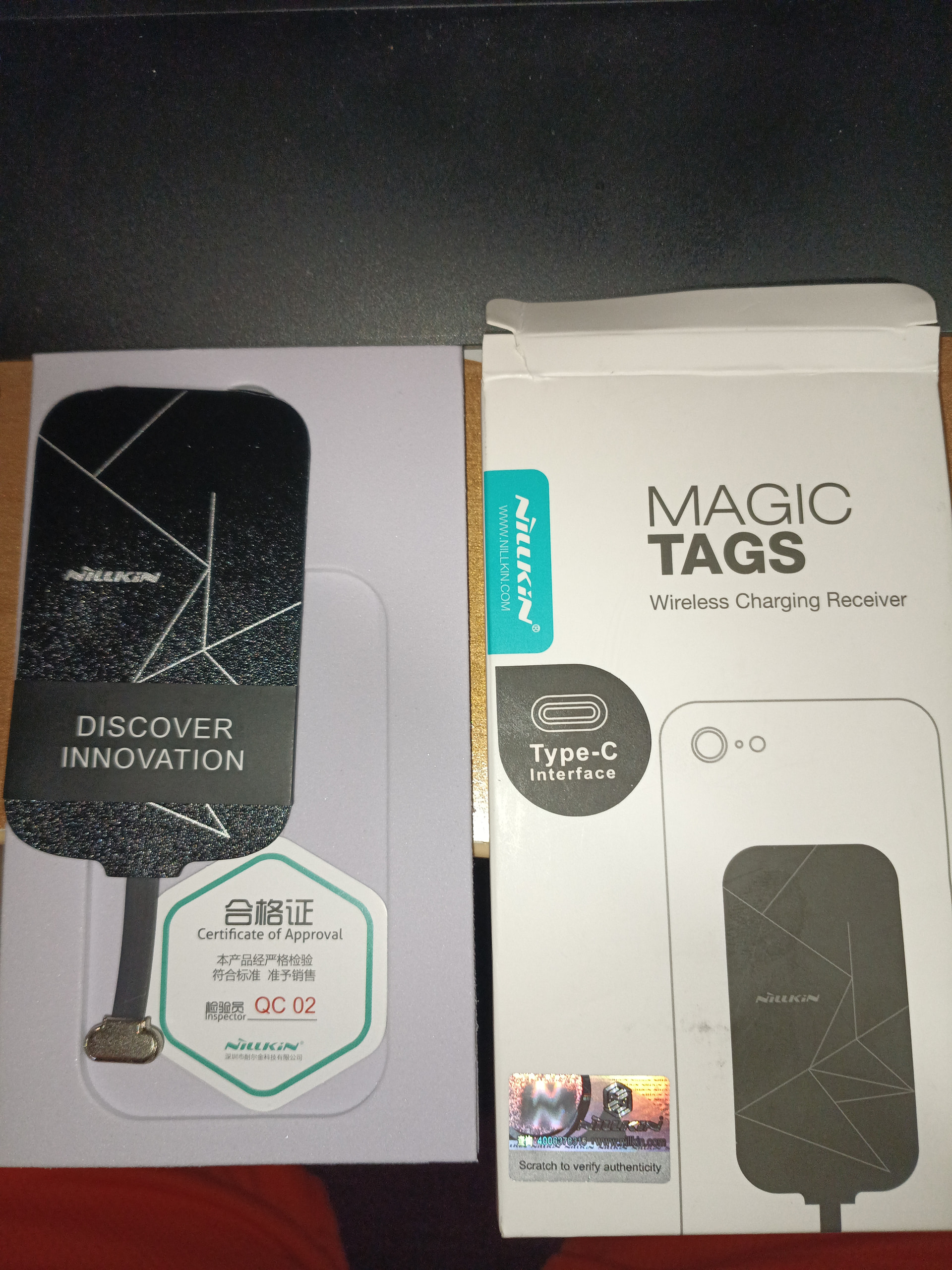

Hi.
I believe it was this one.

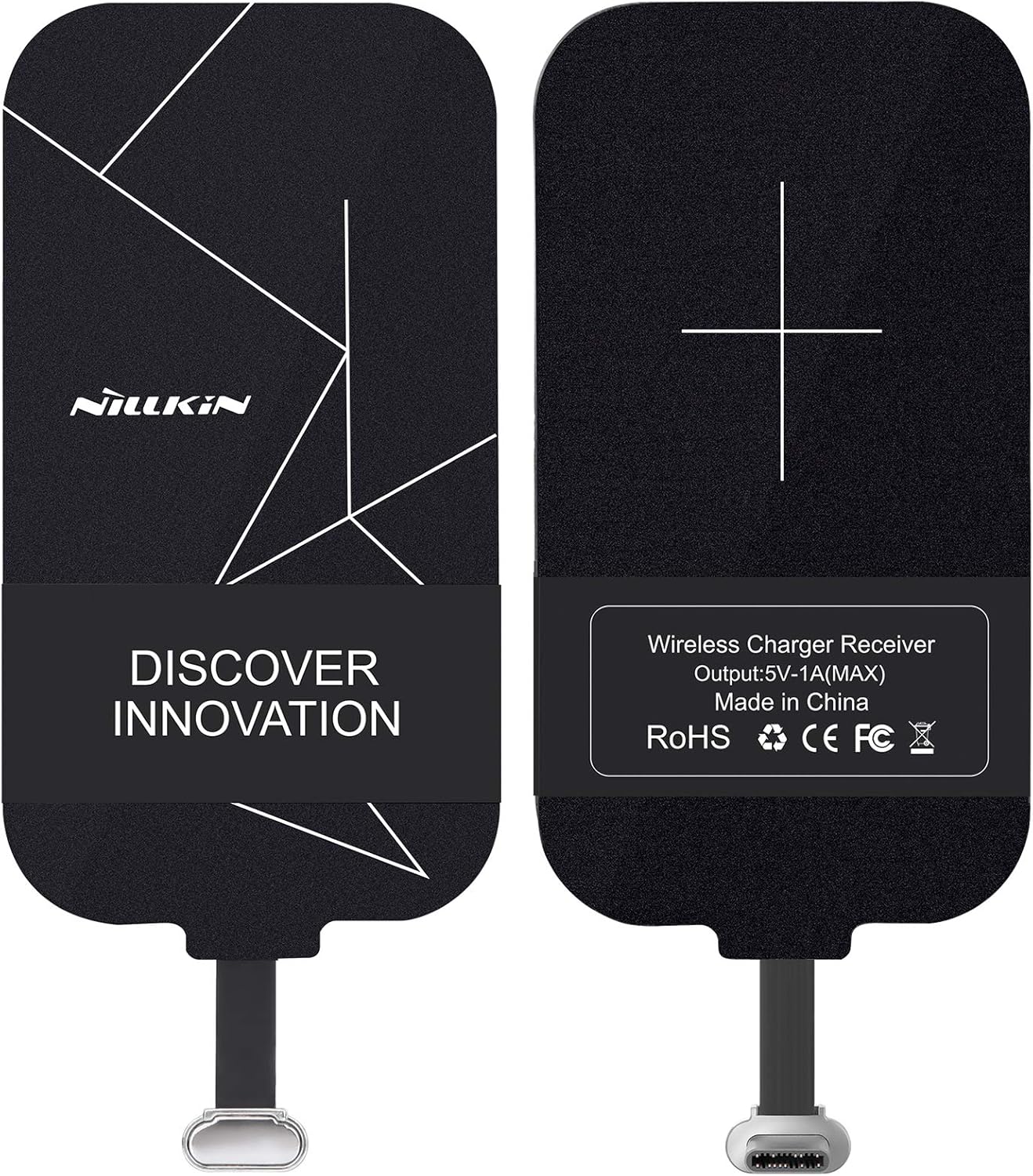

This wireless charger method did not work for me. I connected the external receiver to the USC connector on the phone and inside the transparent case. Just like the video that Rob produced. The phone would continually connect and disconnect in a loop state. I tried it on 3 different wireless charger bases and the problem remained. I removed it.
Similar for me it wouldn’t wireless charge in my Mercedes
Same here. Does not work with the transparent case and the corresponding Nillkin PowerHold Mini Wireless Charging Stand. Charges ok up to about 90%. Then starts to endlessly disconnect/reconnect.
However, Nillkin charger and receiver work fine on my Pixel3a.

I’ve been using the Magic Tags @ 5 volts and 1 amp and no problems. I also can restrict charging to 80 % too protect the battery. Find it on Amazon.
