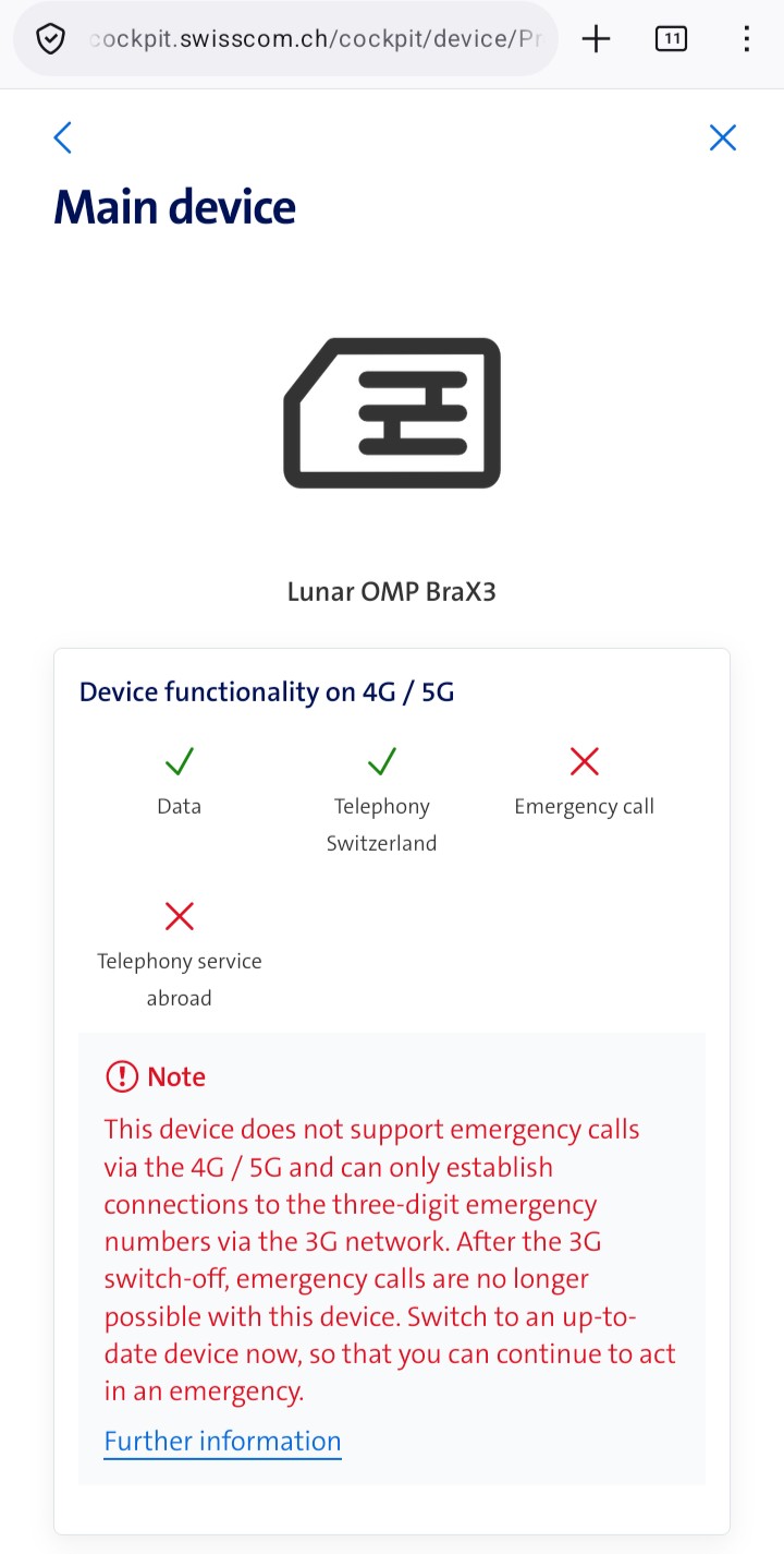

Does the BraX3 fully support VoLTE? If so how do you check if its active? I can’t find anything in the cellular or sim settings?
My carrier says it’s not. Sadly, it’s seems unable to do VoLTE Emergency Calling, which is a bit if a bummer, as 3G is being phased out where I live.

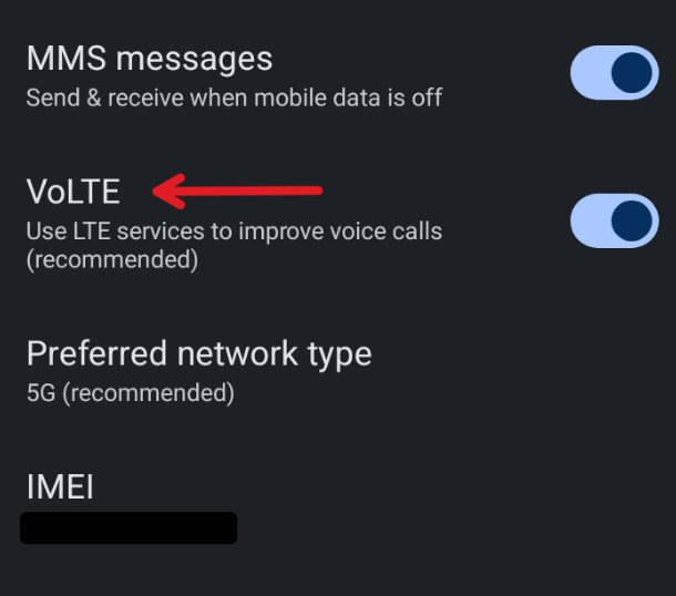

To Check VoLTE settings on the Brax3:
Settings > Network & Internet > SIMs > Click on the phone Number > Scroll down to VoLTE
It’s already turned on.
I also double-checked the IMS Status. VoLTE is said to be available.
On the other hand, Swisscom web portal, still says my phone doesn’t support 4G/5G Emergency Calls.
