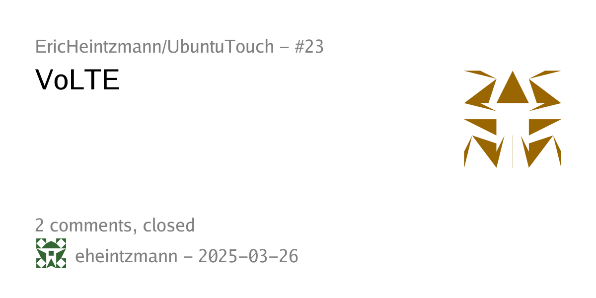

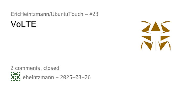

You are probably already aware, but for those interested in VoLTE support on Ubuntu Touch, it is now enabled on several devices.
Personally, I use it on my daily driver.
Here is a link to some tests conducted before enabling VoLTE on the Poco X3 NFC / X3
