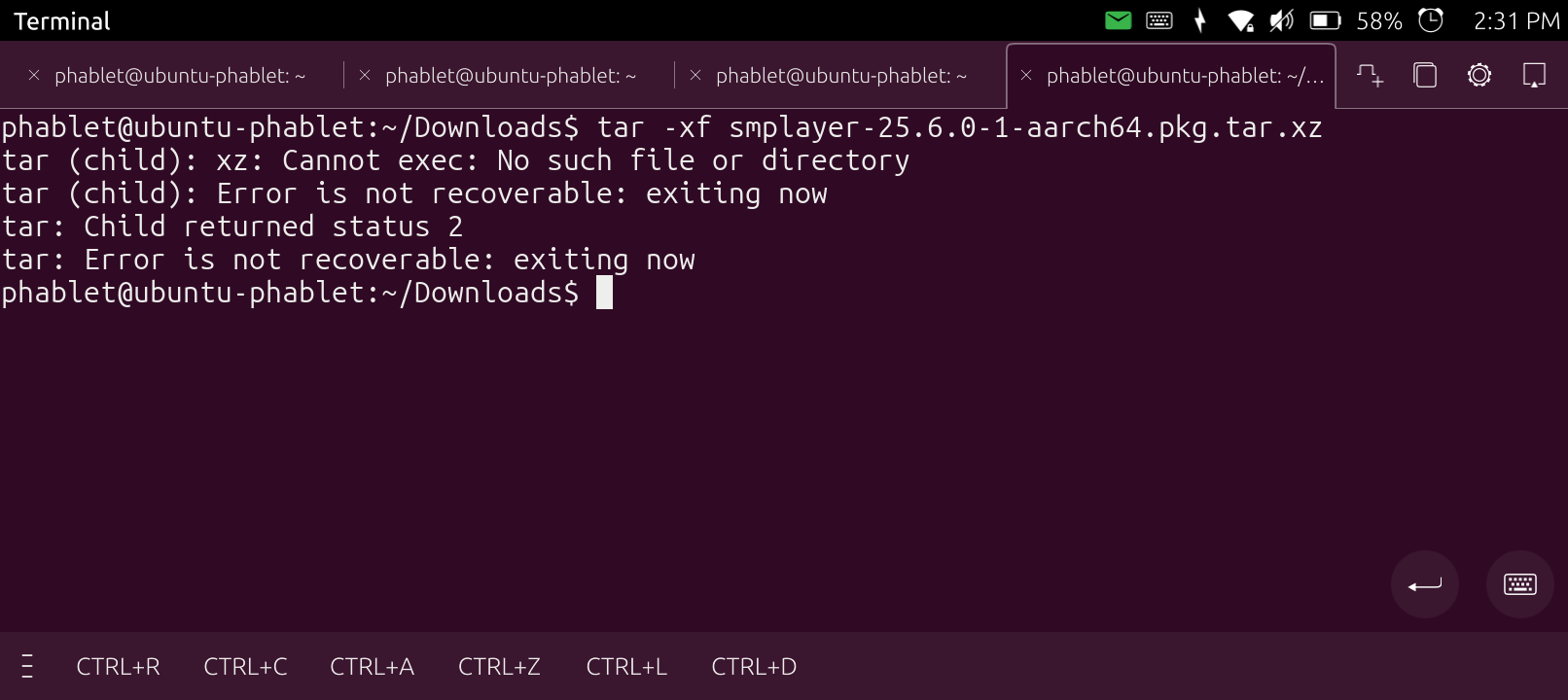

I will create a second script to kill the first one by PID. Tar in UT didn’t know what to do with the file that arch compressed. I took a screenshot for u and attached it.
As I can understand it calls xz to decompress the file but xz is not installed, tar just packs all the files in one, it doesn’t compress.
Try the unxz command and then tar.
