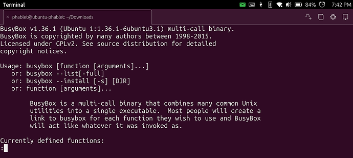

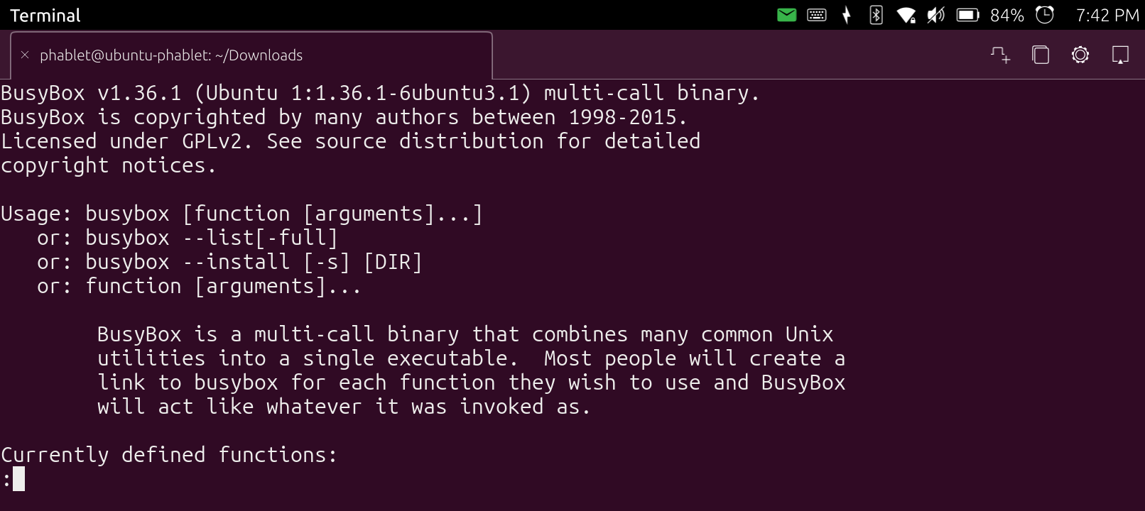

The whereis command does work in UT. When I first installed UT I was trying to find things using locate and that is not installed. Using Libertine I was able to install plocate but it should include updatedb and did not, so I’m not sure if plocate works. Thanks for letting me know about the whereis command!

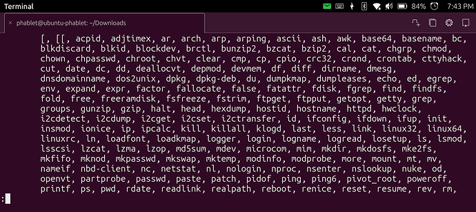

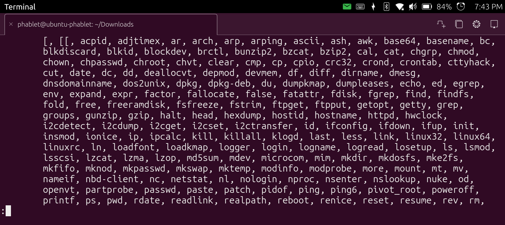

It may be using busybox, try the busybox command
Excellent!
Right again George!

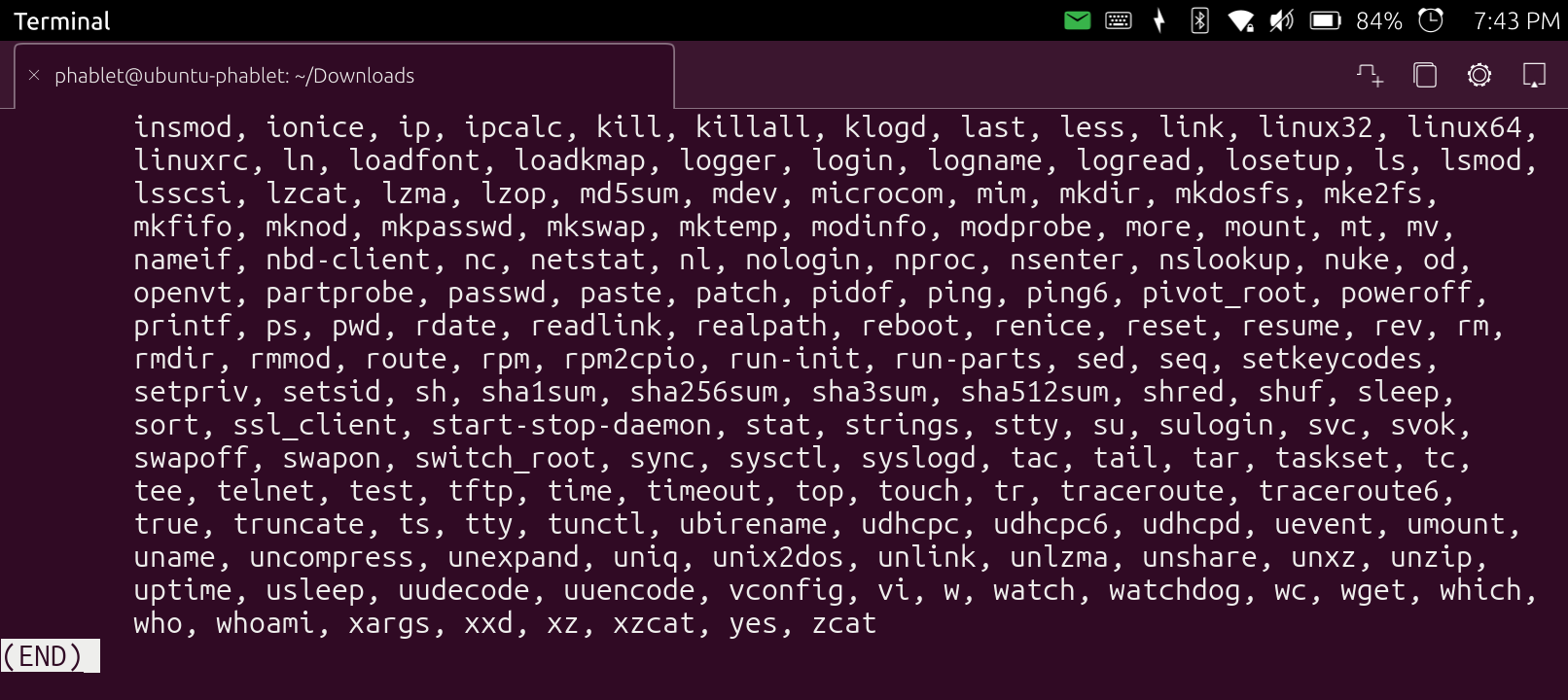

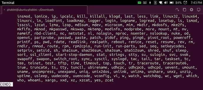

It seems to use some mixed configuration, xz exists there but not whereis, try to run xz like busybox xz or somehting similar.
Can you run xz alone?
Why tar couldn’t find it?
You’ll have to create symbolic links to busybox inside the /bin directory so that you can call busybox commands directly.
xz by itself says command not found.
It is found with this:
busybox xz
So you can create a link in /bin
