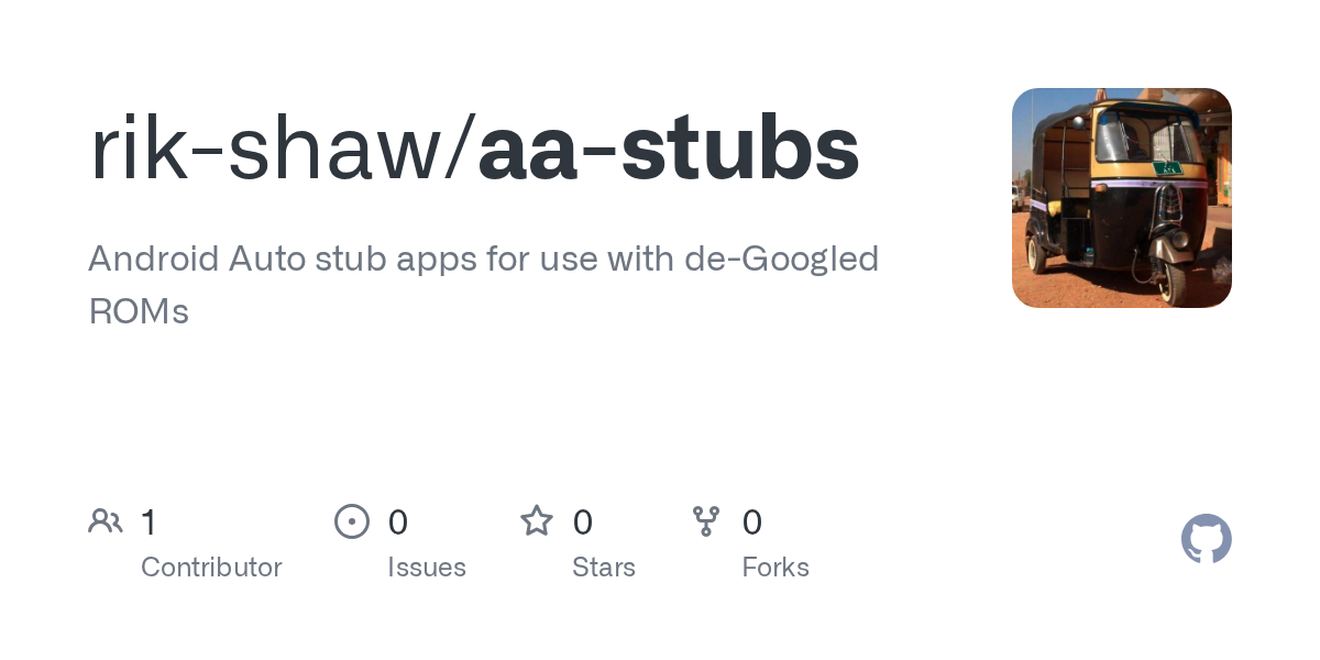

I again don’t have access to an Android Auto capable car, so I can’t test to confirm exactly how it works. But as I know the stubs are in this project:
GitHub - SolidEva/android-auto-stub: Android Auto Stub
Android Auto Stub
You will find the 2 .apk files in the speechservicestub and the gappsstub folders.

I thought I’d just post I finally got around to setting up my phone’s AA (as I’m getting close to finally switching off the iPhone) and it worked perfectly first time on the BraX3. Easy install with the 3 stubs (after updating AA in Aurora) and a bit of testing in the car (Mazda) - just in the garage - and the default apps like CoMaps worked fine and behaved as expected; I also could also access Phone, SMS, Music, apps and such, and they all responded to car controls. Nice!
Still need to put in an actual TTS/Voice Assistant, and test it out driving - and didn’t test a call as no sims in the phone yet - but basics all ticked off and operational.
Special thanks to @rik for his responses and advice in a couple of different places; and for consolidating the stubs in one place for easy access to download and install! Details here for anyone looking for it in the future:
