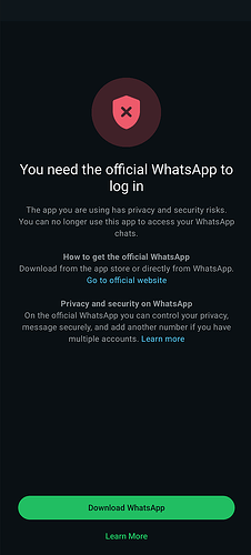

I also have relied on several apps on my phone in the past such as My Fitness Pal, WhatsApp (for work), and Zoom & Teams. Do you know if those work by chance?

WhatsApp
Well - I see you say it’s for work - personally I wouldn’t go near WhatsApp with a barge pole, and won’t have anything meta on my device (as it’s contrary to privacy and security). But that’s an individual choice and plenty of people do put it on - I just can’t understand why (even if its supposedly needed for work)… But that’s just my personal preference. FWIW I use Signal (actually Molly), Session is probably the best overall currently but more complex to use, and Signal is almost as good and has more chance of adoption by large numbers of people (and contrary to popular belief doesn’t require exposure of phone number for people to connect to you, etc). There are other options but they are a bit more obscure - see links below for more info.
If you do need to have it, the best advice I have is to put it into Work Profile with Shelter and freeze it as much as possible and don’t allow notifications - just have a routine of checking occasionally (at a frequency you need to) and refreeze every time. Work Profile and Shelter may not be perfect but it’s the best way I can think of currently to put it on the device and not totally compromise the device to zuckerberg…
