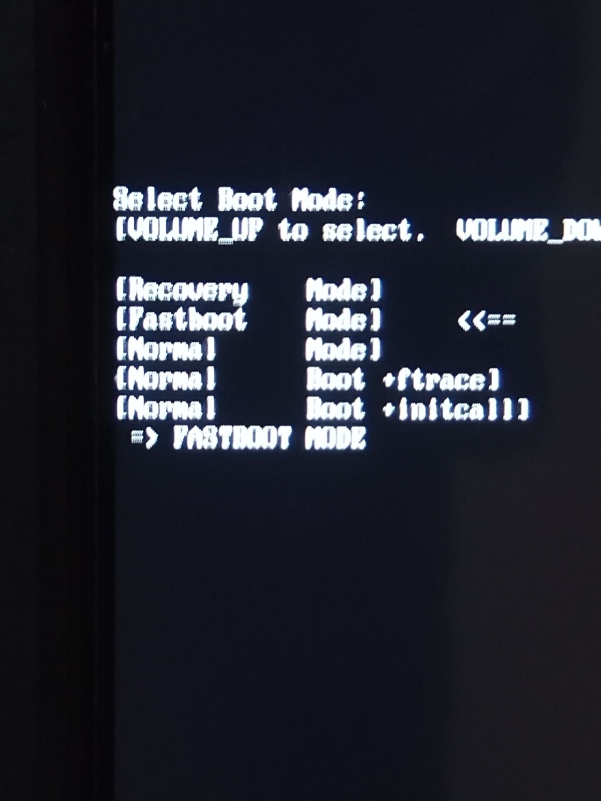

Hello. My Brax 3 phone stopped working for no apparent reason. It is unable to complete a boot up, and has been frozen on the screen seen on attachment for the past 12 hours. The volume buttons and the power button don’t work. The phone cannot even be turned off. I tried charging it with the power chord, but that doesn’t work either. What’s more the Brax 3 phone now feels warm and I’m concerned that it may explode or become a fire hazard. What can be done to safely tur
n off this phone? How can this phone be fixed? If it can’t be fixed, how can I return it and get my money back? Thanks.
I’ve gotten the BraX3 caught in a bootloop several times after flashing in fastboot mode and found that it can be powered off when it does this by holding in the power button for a long time…even after it looks like the screen is blank. I’d say hold that power button for about 30 seconds to make it really power down and not start a bootloop again!
I hope that works for u! SPFlash always works with Lunar OS and makes things easy…if u have LInux I got it to work that way and wrote about if u search. I’m not sure if flashing is something u are comfortable with. The problems I had with that program were always when Ubuntu Touch was on the phone which doesn’t sound like that’s your case.
Try to flash Lunar OS on it!
Fortunately it is difficult to hard brick the BraX3!!:nerd_face:
