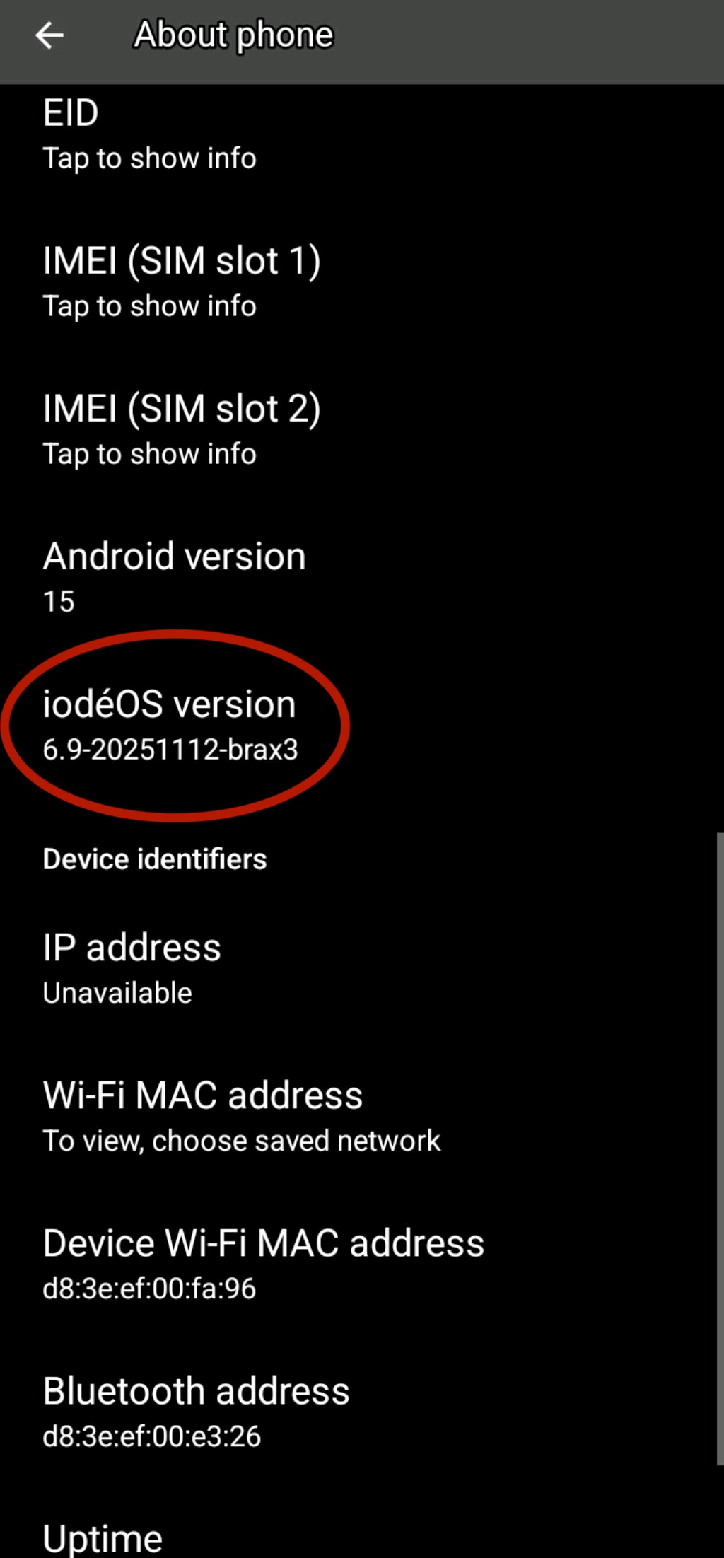

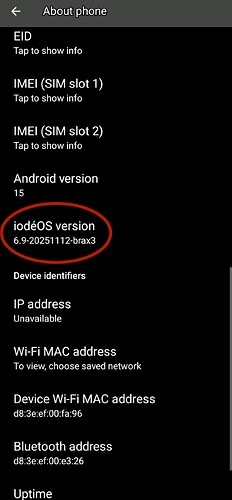

I installed the beta using this link SwissTransfer - Send large files securely and free of charge. However, the device could not connect to the router which is Netgear AC1900 Cable Modem Router Model C7000v2.
