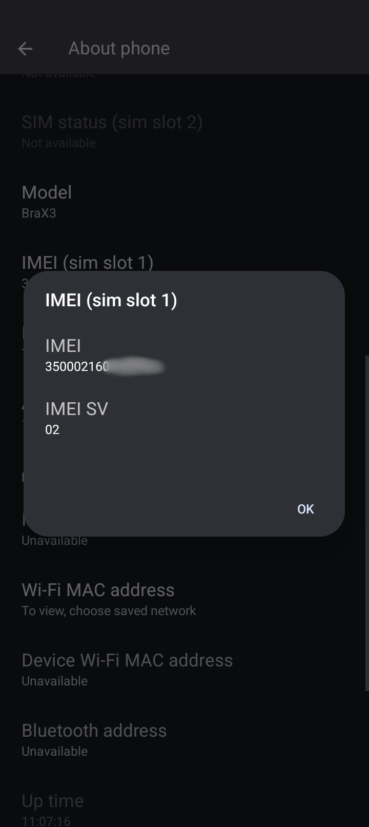

Here is what I did to get the IMEIs back this time. Last time I read somewhere that u should disable a PIN code on the lockscreen. So I did that. I also picked the format option in SPFlash and wiped everything…this removed the serial number. Then I read this guide again on changing your IMEIs:
I then tried a different USB port (one by the power supply seems to work).

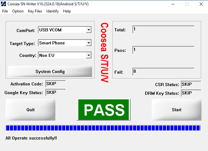

I unlocked the bootloader again which may have not been needed. I also did adb devices and made sure the device would accept a connection from my Windows mini PC. Then SN_Writer gave me this:
