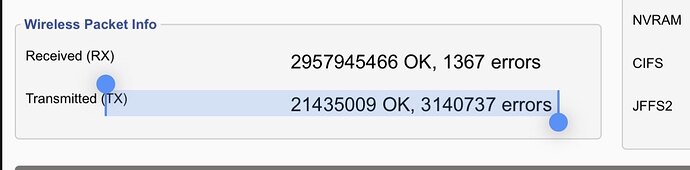

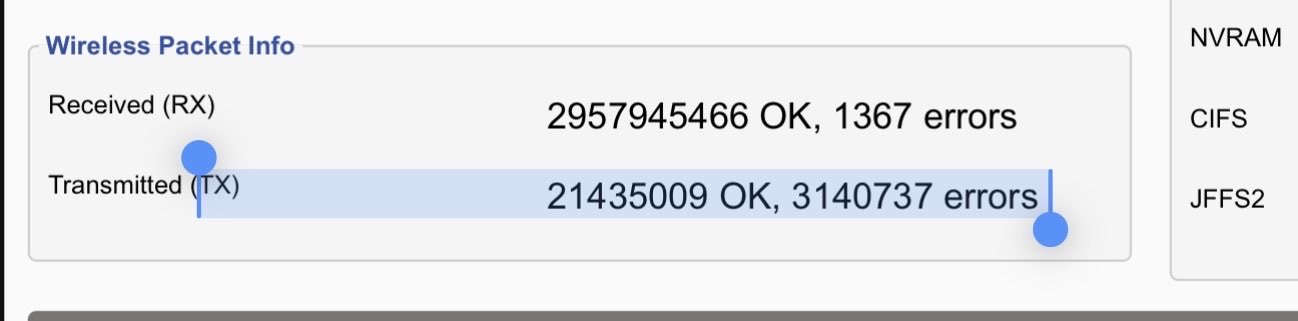

I can concur that with the equipment which the bug of mediatek is at fault with, there is a problem of speed, reliability, numbers of errors of transmission occuring.
This is clearly distinctive on the dd-wrt platform which displays it .
This has strictly nothing to do with the wifi 5 specs of the phone. Nor interference. Nothing. Simply the bad connection and handling of datagram transmitted by the brax3 to the antennas. It does not happen with qualcomm phones. or Others.
The consequence of this is unreliable network connection, slow speed because datagram need to be resent several times in order to arrived, temporary loss of connection, higher latencies (I have next to the antennas 400 pings then 200 then it goes straight back to 60-40 while on qualcomm phones I have from 200 in the first ping to directly 7-10 ms) etc.
So it would be nice that we had a timeline and regular updates concerning the resolution of the bug in the firmware of mediatek concerning the wpa standard.
Thanks in advance for your cooperation.
