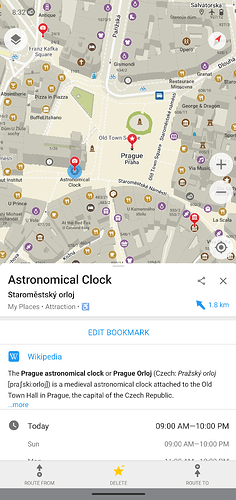

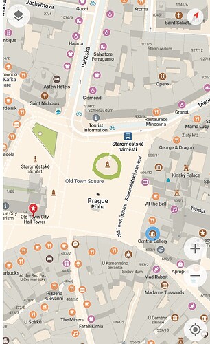

But, joking aside, the answer is earlier in this thread; if you need traffic input namely:
Otherwise the default coMaps or Organic Maps that it was forked from (I always used the latter int he past on my iPhone unless I was driving at rush hour into or out of town and had to have traffic info, FWIW):
