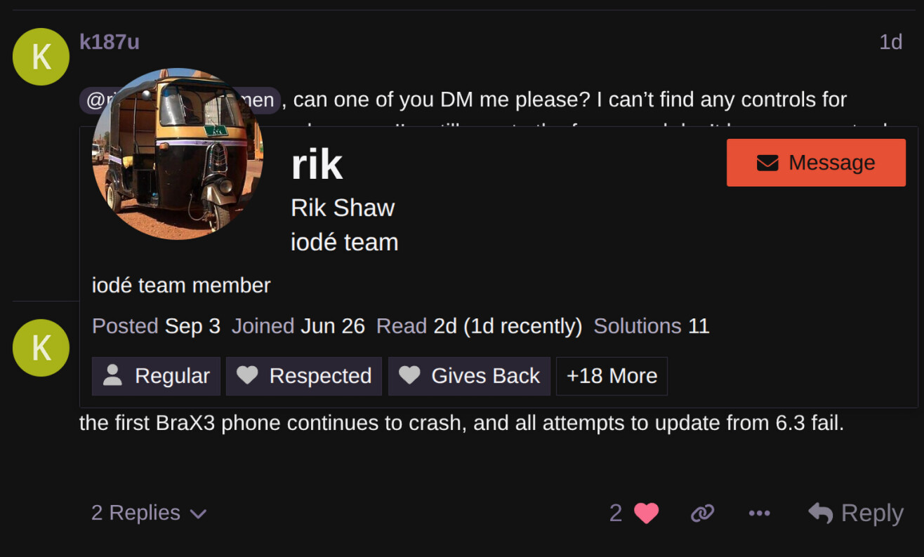

@rik and @plamen, can one of you DM me please? I can’t find any controls for sending a DM, perhaps because I’m still new to the forum and don’t have access to do that yet. Thanks!

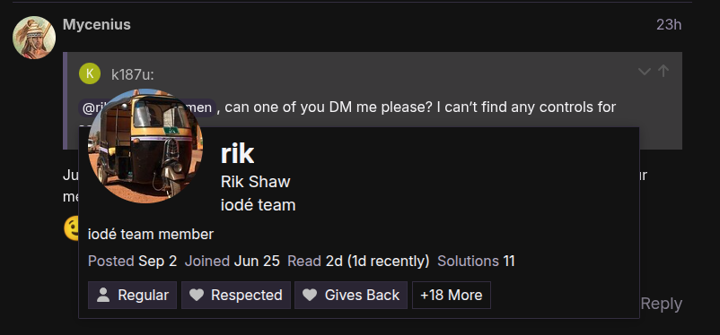

Just tap or click on the person’s name in any post or similar (like the tag you put in your message above) and choose “message”.

Thanks, however I don’t see a message button when I tap/click on usernames. Presumably because I’m new to the community? Sorry if I’m missing something obvious!

Yeah looks like you are right - you have not been here long enough to do DM’s - need to like a few more posts an maybe comment on a few (not sure how many it needs to be - maybe 5?) - FYI this is what you should see once you have the trust level:
